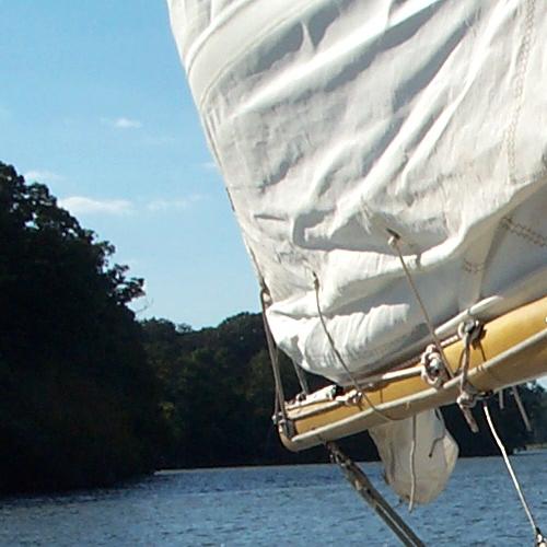

cleat on the boom
Don, I can't tell you how its attached at the mast head but it is fixed on that end. It is very thin wire (sorry no dimensions) that runs to a block on the aft end of the boom. It then converts to rope and runs parallel to the outhaul along the boom to a cleat just past halfway to the mast. I didn't set it up that way and if I were to do it I'd leave it like it is except to put the cleat closer to the aft end where I could easily reach it from the helm. In the attached photo the cleat further forward is the topping lift the aft cleat is the outhaul. Enjoy, Mike
