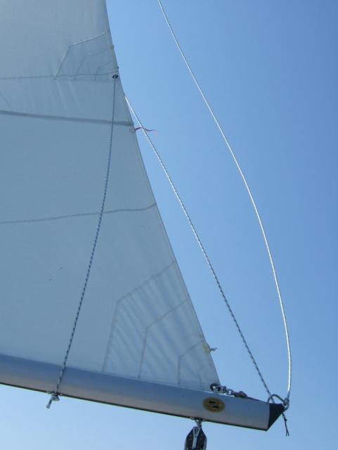

Topping lift
I stopped routing the topping lift through the boom and just attached a shackle to the end of the line. I just snap the shackle to the end of the boom leaving enough length so it is never taut when the main sheet is pulled tight.
