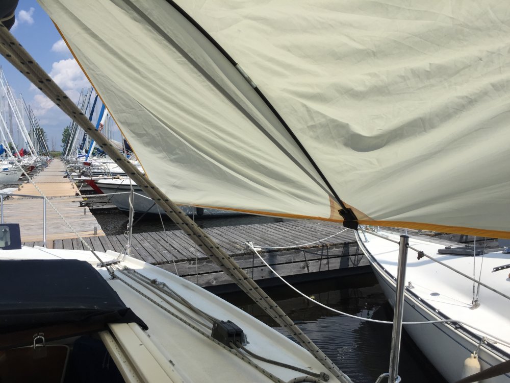

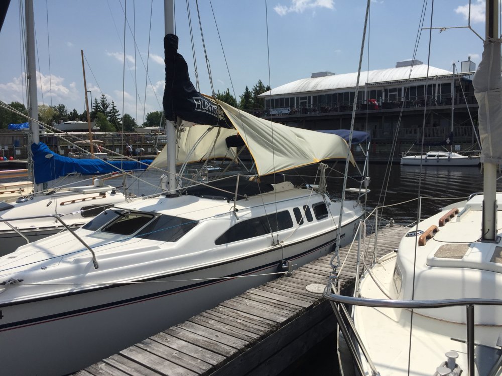

For my H26 I use an old nylon tent fly that is 8.5 ft wide. This allows the fly to be draped over the flaked sail (and cover) on the boom and attach to the life lines with Velcro ties. I was just sewing on a few additional Velcro attachment points when I saw your post come in
The length is the same 8.5 ft along the center line but flares out to about 10.5ft along the edges. On the aft end it drapes over my Bimini. Each corner has 1 ft of shock cord with plastic hooks that allow me to attach to baby stay attachment points on the front stanchions and the lifeline attachment points on the stern rail.
It’s not ideal but it is based on what I had available and works quite well. I’ll try find or take a pic.

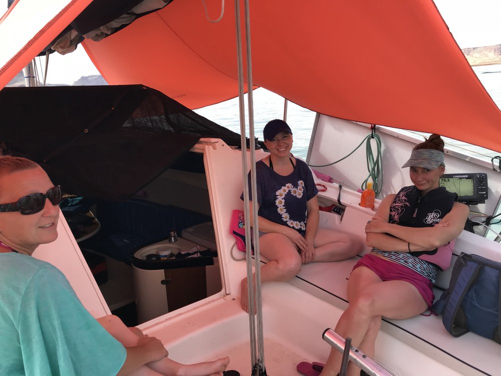

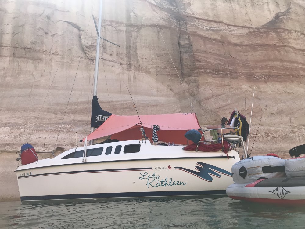

I use the grande neso tent made in Southern California added a few grommets it works great. It’s really stretchy material so it gives a lot in wind with out ripping anything.

That is a great photo with the wall as a back drop, nothing like that down here in Florida. Did not know that there was enough wind to sail up there. Have a great day!
View attachment 153600 I use the grande neso tent made in Southern California added a few grommets it works great. It’s really stretchy material so it gives a lot in wind with out ripping anything.View attachment 153599
