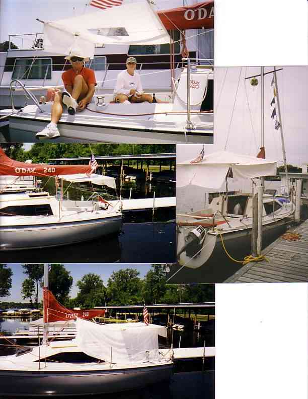

Versatile Bimini(s)
I've built 2 Biminis for my O'Day 240 -- #1 mounts below-the-boom, #2 goes above the boom. We use #1 underway and #2 is for at the dock or at anchor (but, truth be told, for stops of a day or two, we don't switch Biminis). Both designs utilze the same pair of adjustable Forespar poles -- the afteone behind the backstay, and the forward one suspended by lines leading to the port and starboard shrouds. Shorter tie-down lines lead to lifelines/stanchions. I've attempted to include with this post a composite photo that shows both designs, and the mosquito net that fits below either Bimini. The net adds a feeling of a "whole upstairs" to the boat. Upon initial set-up, measure and add clips to the aft pole tie-downs, then you'll find that future deployments are a snap. (If the composite photo don't make it with this post, I'll be pleased to send them via e-mail.)

Versatile Bimini Photos
(Ref. my previous post, "Versitle Bimini(s)" Sorry that the composite picture didn't make it on 1st shot. (Attempt was made with wrong file extension.) Success this time!!!
