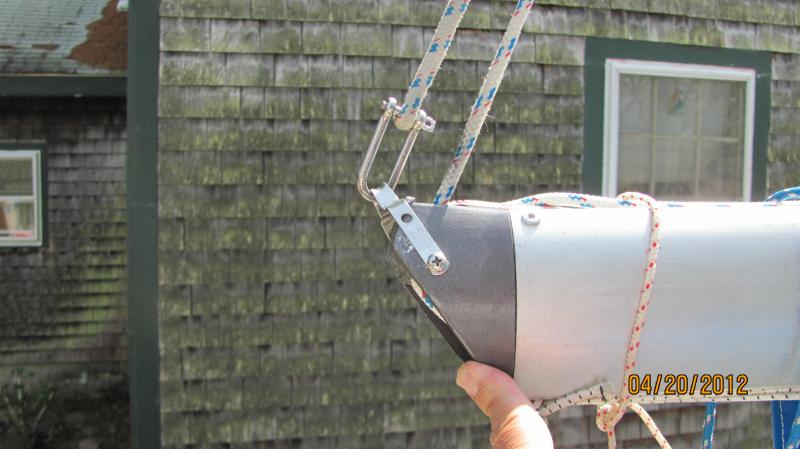

On my 25 I added a carabiner to connect the topping lift to the boom. I have sailed with it connected and disconnected. My problem is I want the TL to hold the boom high which keeps it under tension with the main up. I have seen a few configurations for adjustable TLs, including one on an earlier thread titled New Pocket Cruise Illustration. I like that one as you can put a knot in the line to keep the line from running through the cheek block. This way you just let the line loose for sailing and pull up the boom after dousing the sail. The knot keeps the boom from dropping all the way when the sail comes down.

The TL on this boat has a shackle on the end, and it is attached to carabiner. It is than attached to the eye in the end of the boom. Sounds like the way you have it rigged. If that works for you I'll try it as is. Thanks. I was thinking that the block & cleat were for reefing. My main sail has 2 reef points; however, only 1 has the sail ties in the sail. Apparently the PO had it rigged for 1 jiffy reef line. That works for me. Thanks for confirming. I used to sail on the Barnegate. Cat Boat, Gaft rigged, cotton sail. 1960's. Great times Thanks again.

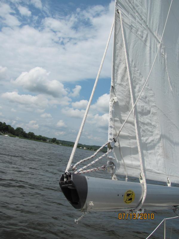

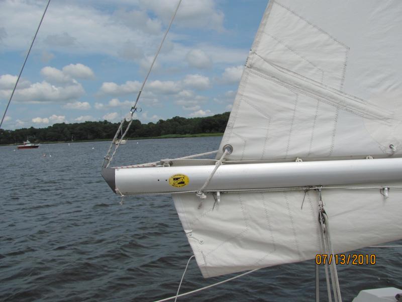

You could make the TL adjustable by putting a sheave at the end and running a line from the end of the boom through the sheave, and through the cheek block near the end of the boom to a cleat near the goose neck fitting on the boom.
My spar set up has internal halyards and boom control lines with cam cleats under the goose neck but basically it works on the same principle.
Also, the first pic shows a bale attachment at the end of the boom that I just recently installed last year.
