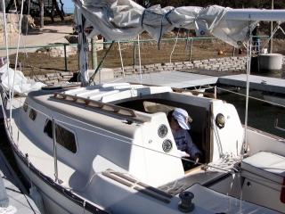

Our '79 H25 has a much shorter boom. The foot of your sail sounds about right, so my guess is that the boom is a retro-fit from another boat. Our boom gooseneck is mounted to a vertical traveler on the mast with a cunningham. Our mainsheet traveler is mounted athwartships on the bridgedeck between the cockpit and companionway. See the attached photo - the end of the boom is just barely out of the photo.
