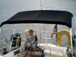

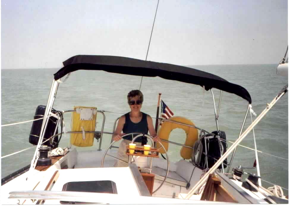

Being cheap and having a new North main I was not about to cut the sail to move the boom. I am over 6' and have lots of headroom on my H37C. I made my three-bow bimini from a Sailrite kit. The aft bow is 2' behind the backstay and the middle bow is right at the backstay. The foremost bow is well forward, probably 4'. But it is lower, low enough that the boom just about touches it except when sailing. So I duck a little when going out from under but have standup room from two feet in front of the wheel to the back.

Ed, More Pictures?
Ed, A sailrite bimini is one of the projects in the near future for me. Do you happen to have a picture of your bimini from the side? It would help in determining the forward/aft placement and height of my bimini. Also any lessons learned from the sailrite kit? Did you go with the 7/8" or 1", aluminum or stainless steel? Thanks, Mark

Ed's bimini.
Here's another not very good picture that might help. The back support is about 10" ahead of the pushpit and at the same angle. I mounted the feet by drilling and tapping the toerail. This got me the most width. As you go aft to get winch handle clearance you lose width, at least on an H37C that is true. I am sorry that I did not opt for the large stainless tubing. It is like new after four summers but we are on fresh water. I know it will corrode in saltwater next year. Easily upgraded though. Also note that the middle and front bow supports are adjustable on the main support. One setscrew and you can adjust to the height you need.
