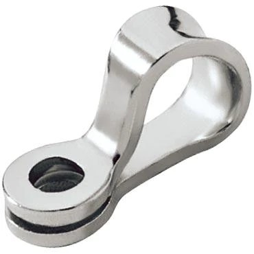

It looks like it was installed to prevent the sheet from catching on the vang pin. Perhapse you could remove it all together and wrap the pin with chaffing tape instead.
As far as what it is called, it looks like it performs a similar function to this eye becket.
But, every Google search I did on "wire becket", "eye becket", "sailing hardware becket", "sheet becket", etc., led either to this image, a becket strap (to hold hammocks up), or block hardware.
-Will
