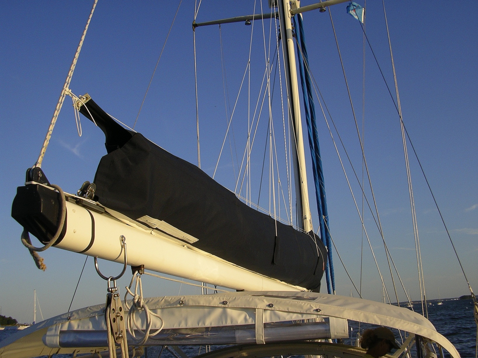

This could work.... it's called a "boom bail bearing plate" Click on the picture for clarification.
