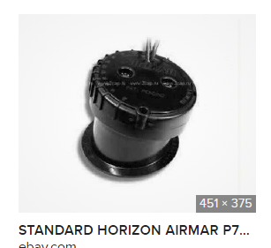

Most of the transducers used today are made by Airmar. They make a transducer that has its own mounting bracket. Do a little investigating, you may be able to buy a Garmin display and use a compatible in hull transducer.

The benefit of the Airmar base is that it can be adjusted to the correct angle and the transducer easily mounts. The connection tends to hold in the water "coupler" that is required.
