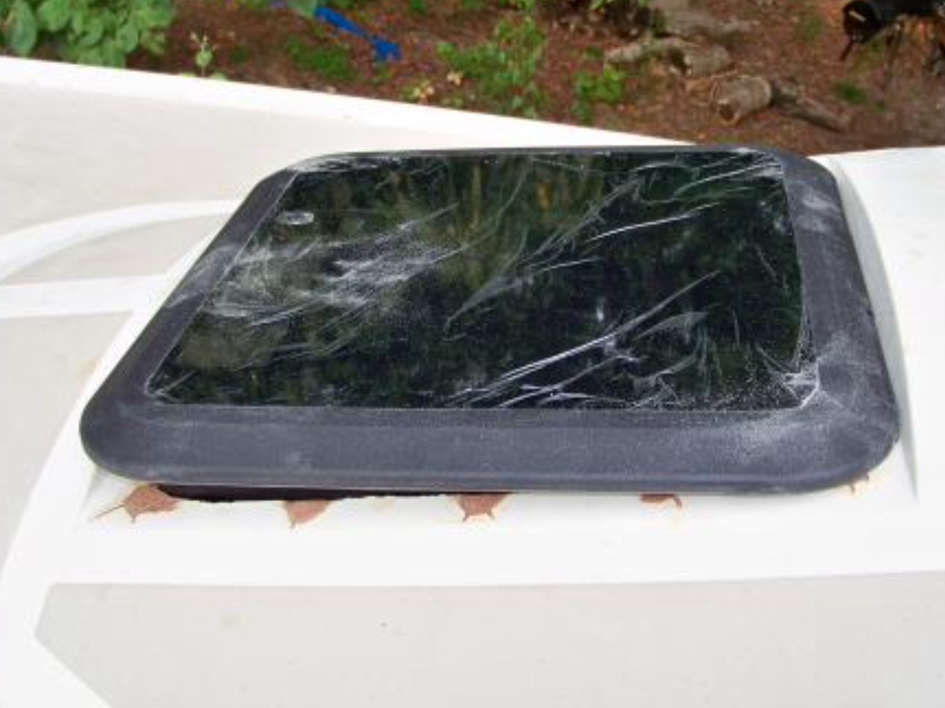

I had an oday 26, I was able to use a slightly larger hatch by cutting a "spacer" out of a 3/4 inch piece of plywood that I sealed and painted. It also lifted the edge of the hatch off the surface of the deck which decreased the chances for leaves. Let me see if I can find a photo to show you what I mean. Ok, in the pick below, imagine now I have added a spacer between the hatch and the deck
. That lifts the hatch, giving you more space to fit the hatch.

Hello Captain Stanley, We replaced the forward hatch on our 1988 272LE with a new all plastic hatch. Worked OK for a while, but then started to see leaks around the frame to deck joint. Not enough caulk? Maybe. I also thought that some sort of wooden rim to raise the frame of the hatch above the deck would be a great idea. Water seemed to puddle and work its way in from the top (aft) edge of the rim. Used tape to cover the area.....yes, down and dirty plus ugly! I would not choose plywood. Look for a source of teak from a used boat parts place. My solution was to sell the boat after pointing out the leak to the buyers.

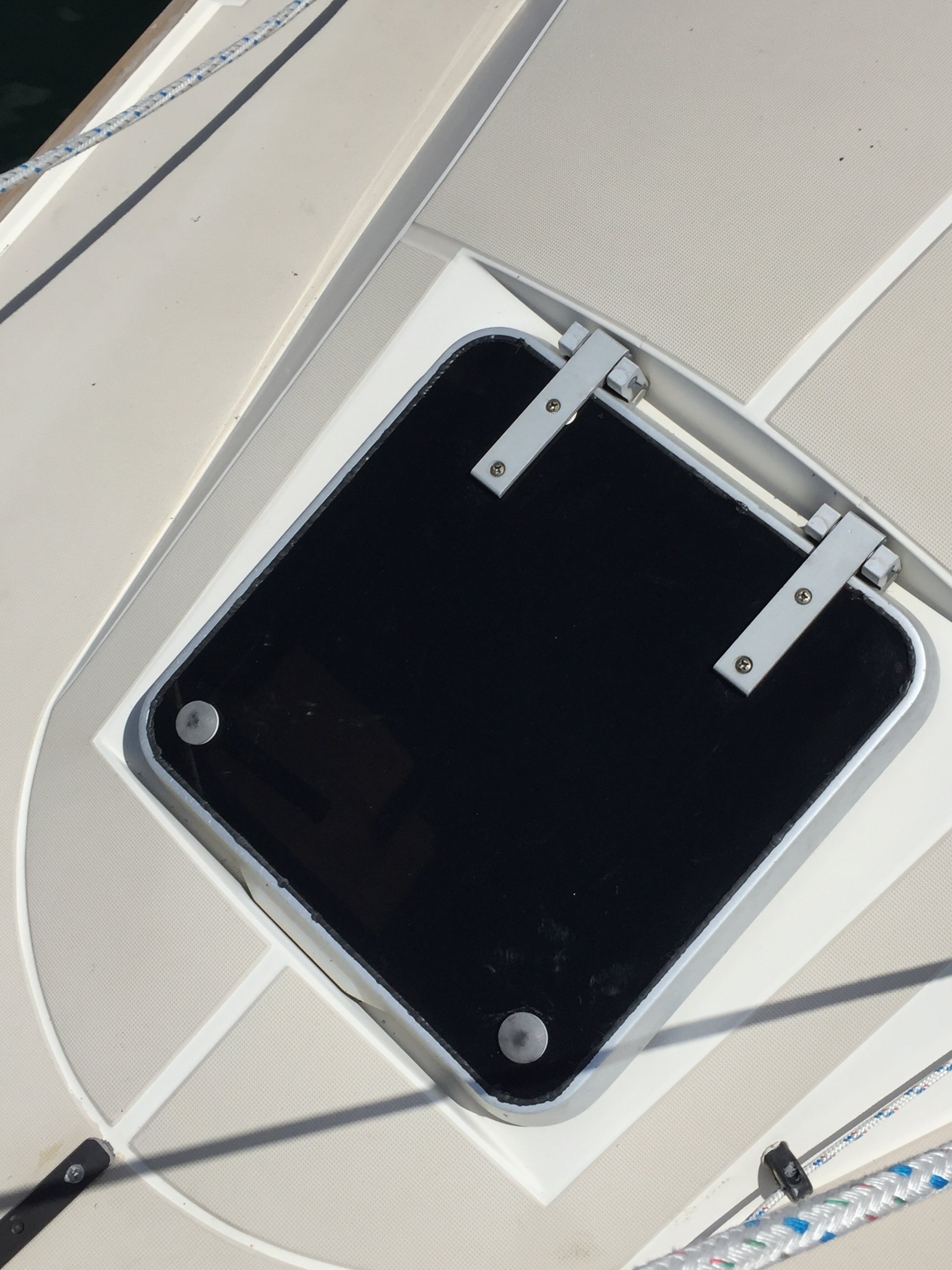

Perhaps the plastic flexes too much with temperature changes? I have the metal hatch, and it never leaks. I replaced the 30 yr old plexi in it this season. It looks great.

I would rather replace my hatch with an aluminum hatch rather than another polycarbonate (plastic one). Your hatch looks good and it just fit in the opening with no room to spare. Do you happen to know what brand and model hatch this is?

I looked all over it when I had the top out to reglaze it. I could not find a maker. It must be under the frame.
I am thinking Bomar, but I don't know.
