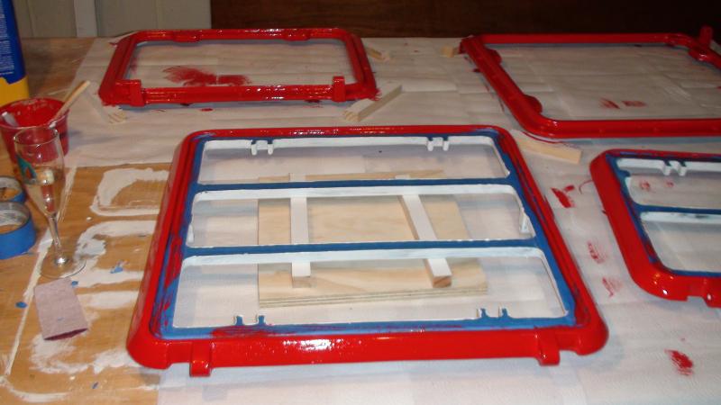

I have removed and painted my deck hatches , i will be rebedding new acrylic lens's in the next few days, has anybody else here overhauled them and remember the size of the roll pin's used on the hinges? I would like to order from mcmaster-carr (huge price difference) but i don't have calipers to determine the exact size and have found no specs online, thanks

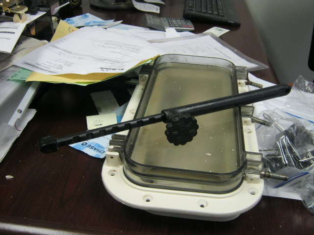

While here, on both my hatches, are there tow supporting arms on both, or only one?
I have extra, but it appears as if they are supposed to be two... there is even a connection for the second one

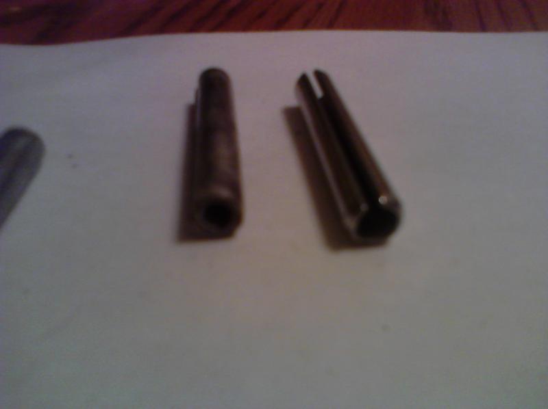

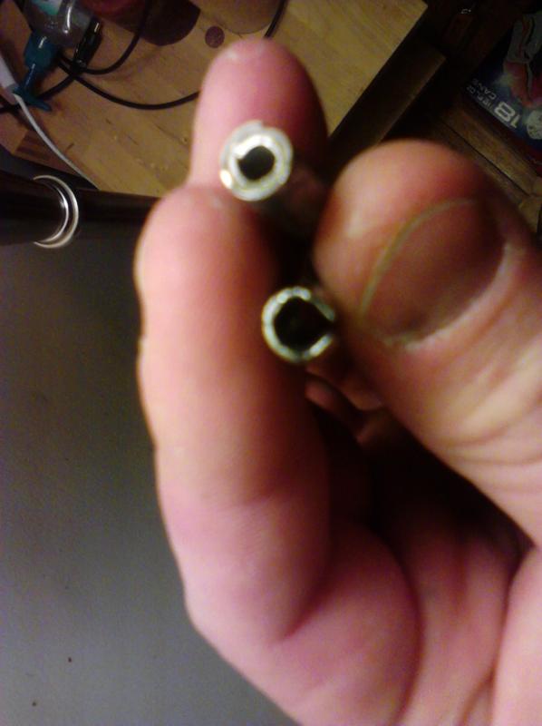

thanks Ed but I ordered some from mcmaster carr already, at 1/4 the price (for 25) I took the chance at less then precise measurements. they are a different style of spring pins the new ones are thicker metal with a central split and the old ones were a thin sheet rolled into a spiral. Theoretically the same principal of expanding force to hold it in place should be about the same. hopefully the ones i got will fit. Jorge, I am missing two hatch "dogs" (the latches) and the two that I have are missing the plastic knobs and I am missing a support arm for the smaller of the two hatches.That is very generous of you to offer, I would really appreciate any spares that you wouldn't mind parting with. As far as the "missing support arm" i think it was intended that it could be switched from side to side depending on the particular boat layout/preference

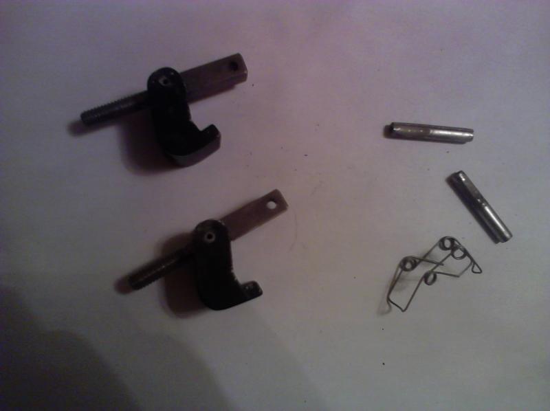

This is a picture of the part I have a couple of spares of: is that the part you need?

yes jorge i am missing one of those. I am also missing two of the round plastic knobs to go on the latches pictured, as well as two entire latch assemblies, same as pictured below.
