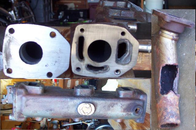

He's like my brother, so, YEAH, I'M MAD AT HIM! :cussing: But it was mostly frustration and disappointment. Hard to stay mad at Mike for a number of reasons. One is that he is the one who has been spraying it with the PB Blaster every other day, every day this week because I live five hours away. He is a hard working guy who after a long day has to go down a 60' drop stairway, paddle out in a canoe, squeeze into the engine compartment, spray, paddle back and then the hard part, climb back up the stairs.
He tried to talk me into the "two out of three ain't bad" perspective, but I didn't feel it.:cry:

Final Update: Success!
The Moonraker continues it's charmed life. Once again, a major disaster has been downgraded to a past major inconvenience . :) I won't recap since the gory details are right here in this thread. Mike had been applying PB Blaster daily all week.
Arrived Sunday morning armed with a bigger needle nose vice grip and a vague plan to torch at a different angle. After practicing my fast-vice-gripping with the new vice grip, I started heating around the broken bolt, which was still protruding only 1/4 inch. Torch torch torch, wax, grip, twist...THE BOLT MOVED! Praise cheeses!!! The 5 degrees of movement was as good as a hundred miles. I had reached the twist limit in the constricted area and decided to now use the regular vice grip head on. I resisted the urge to call and text "VICTORY!" to everyone. Let's wait until the bolt was all the way out.
With the head on vice grab instead of sideways I realized I could attach the big vice grip first and torch with the vice grip attached so I wouldn't have to do the fast grip move. I changed the torching angle slightly and started torching. Just about had it hot enough and suddenly FIRE! Apparently the different angle of torching hit a puddle of lubricant in the aluminum foil I had coated heat sensitive parts with! I immediately grab the flaming aluminum foil, pulled it back and started patting the fire out with my bare hand. Luckily that worked.
The ten seconds of terror did not distract me. Even though I thought too much time had passed I decided to wax and then try a twist on the vice grips. It turned!!!! Twenty more seconds of twisting and the frikken-assed bolt is out!!! A month of worry and planning ends in sweet success. After babysitting the fire site for five minutes to make sure another one doesn't break out I text and call the good news. In another hour the motor is back together and running as sweet as ever. In another hour four of us go for a nice little motor-sail. Now I can sleep soundly again.
