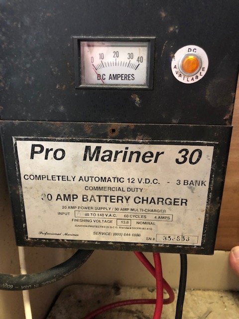

When I came on board my C30 the other day, I realized my batteries were boiling. I shut of my battery charger and sake of good order also disconnected my shore power. I was puzzled as to why they were boiling as I hadn't been on board for a few days and I would have thought that the batteries were fully charged. What puzzled me even more was 10 min. after disconnecting all power the batteries were still boiling.
I have 2 Flooded Lead Acid Deep Cycle 75 AmH which are being charged by an OLD Pro Mariner 30 battery charger (see attached photo).
I am thinking that my battery charger is over charging the batteries, but I would be very pleased to hear your input on my situation.

That would be correct thinking. Be careful when removing the battery charger, it weighs about 35 pounds! A nice new Sterling/ProMariner charger will weigh in at 5 lbs. and not murder your batteries. :)
Nope, that charger is MURDERING your batteries.
Here's why:
http://c34.org/bbs/index.php/topic,5078.msg43151.html#msg43151
I would never, ever plug that POS in again.
You may also be interested in the rest of the topics in that linked thread. We call 'em critical upgrades for a reason and most of them apply to your boat, too.

And you may need new batteries after cooking them for a while.
12,741
I'm not sure that is a "may need" question, I think it is a will need statement, there may be a little more life left in them, however, a new set of batteries is in your near future.
