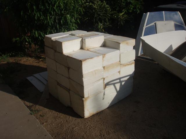

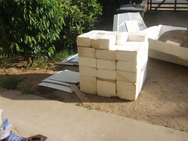

So, how much floatation should your Mac have??
I saw two things that I think contributed to the sinking of Chiquita. First, when the boat turtled, the only thing sticking out of the water was the hull. The 23 Venture had a swing keel and if locked down, should have been sticking above the hull. (If locked into sailing position, it should have righted the boat!) Also, the floatation was removed by the PO.
While I cannot speak for all Macs, I can tell you with reasonable certainty that there is 1 cubic yard (27 cubic feet) of floatation in a Macgregor 25.
Don't ask me how I know....:redface:... the pics say it all.
