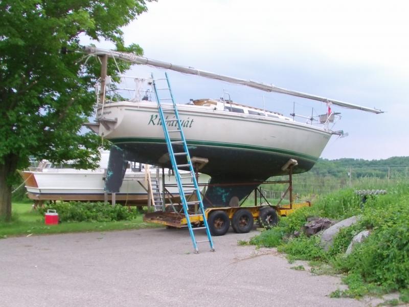

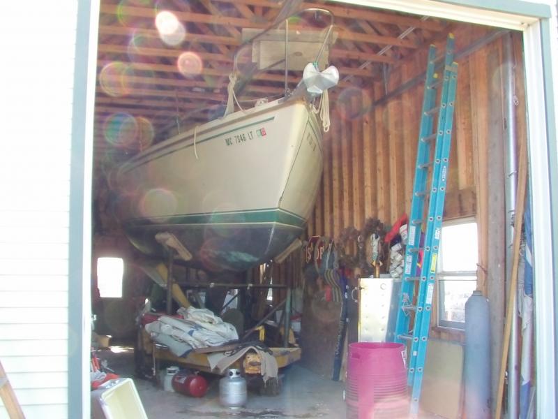

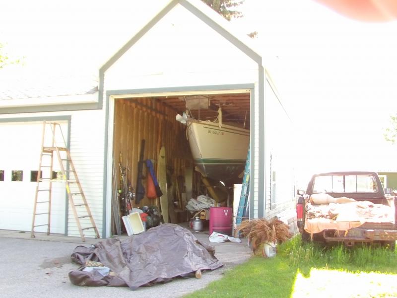

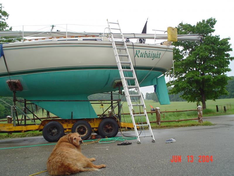

I am using what you want to use YES
You have the ideal set up, the truck , the trailer with cradle. I also have an old 3 axle trailer, no lights or brakes but it works to haul me from Petoskey to Harbor Springs, maybe 10 miles in spring and fall. I have the travel lift, lift and load it, but in Elk Rapids they have a real long sloped ramp that the previous owner used.

Thanks for the additional info B&G and Crazy Dave. I figured that a cradle is a starting point but would not be heavy duty enough for over the road. I figured I would need more supports. I also have hauled many heavy tractors and know the importance of strapping the load down both fore and aft. The trailer I want to convert has brakes on 2 of the 3 axles. Dave thanks for the advise from someone whom has experience in this.
B&G thanks for the pics. You have one heck of a shop to put that in. As some said it does look very top heavy on a trailer however we all know the amount of weight that is down low will help to stabilize the load. The ramp at the club is steep so I hope that a tongue extension will work I and can avoid using a chain. A chain kind of is scary to me. If a crane or lift is not to costly at a marina I will use them.
