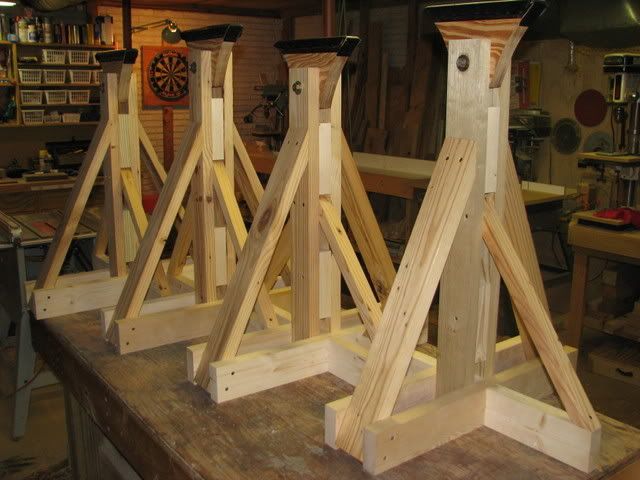

Here are some alternative approaches
I've restored 7 old sailboats so I've fooled around with this a lot. If you like this idea, I can send you more pics. In the first pic, the butt of the boat is sitting on a picnic table.

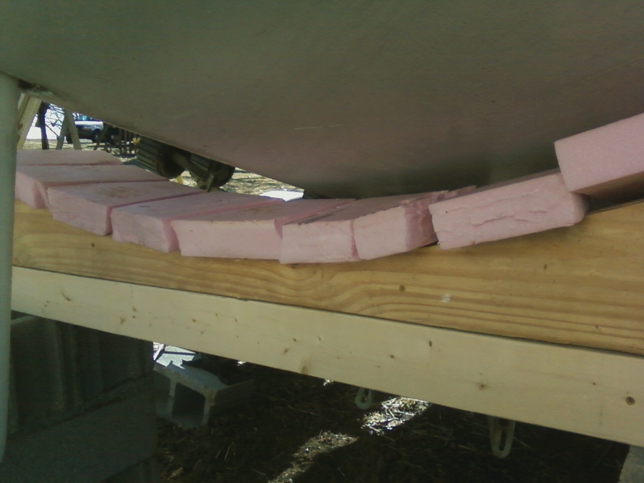

The second pic is a different boat. And I made these form fitted beams and suspended on cinder blocks.

Built from the 4x4s of an old swing set I made for my kids many years ago. Used 3" deck screws and 4 eyebolts from the swings are holding up the boat. You have to use double ratchet straps or you can't lift to any height. Tighten one to loosen the other then reset and tighten that one. I walked all over Dragonfly while she was hanging there. I dropped the CB onto the trailer to get it out, so I lifted her about 18" above the trailer. Worked like a charm.
Cross bracing is a must, whatever method you use.
I wouldn't do this:
or this:
They use to use something like these at the marine ways where I grew up, these are nicer and lighter:
-Will (Dragonfly)
