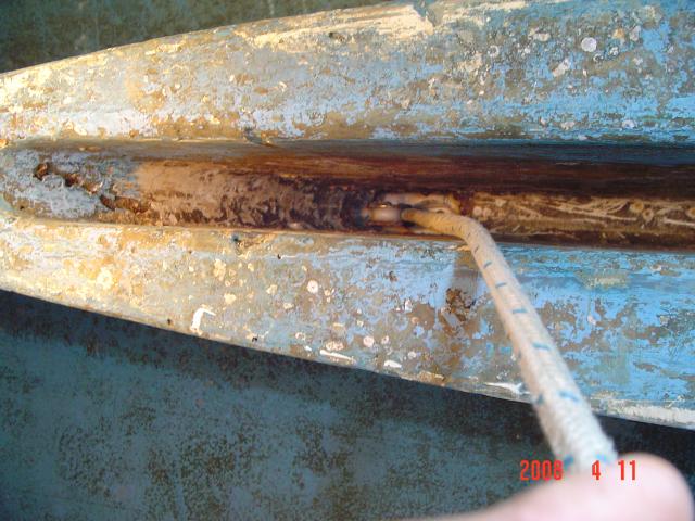

Do you know anyone who has a Loos Gauge Michelle? Your stays are 1/8" so you have a few scale choices to use. I think my outside stays are set at #15 on that gauge and my inner stays are a little less.

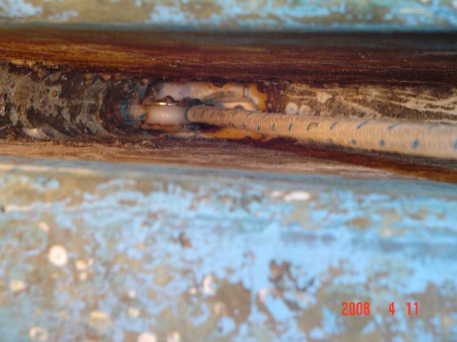

I think that it would be wise to have the boat lifted to get at the centerboard. You will want to also make sure that the centerboard pendant line is running through the small sheave up inside the the centerboard trunk. Chances are that the shackle is still connected to the pendant line and all you need is the rigging pin and the cotter pin. I have a couple of pics that you can check out so you can know what you are dealing with. Make sure that you replace the rigging pin with a pin just long enough to connect to the board with the cotter pin. In other words, you don't want a pin that is too long. Do you have a roller trailer for this boat? Anyway, here's the pics. If you need further info on this, let me know. I just checked the pin and shackle on my pendant line this past spring when I bottom painted my O'Day 222 and it's a good thing I did. The cotter pin was broken on the rigging pin and it was easy to replace while my boat was up on boat stands.

thanks, I have looked at your pics before. No luck on the shackle, it's gone. I'm assuming the cotter pin failed or whatever, and shackle/pin all worked itself off. It's around $30-$50/ft to have boat hauled out onto travellift, so I only haul out onto it's trailer. Not worth hauling out to just change pendant. Used the wire down the tube method and hope it goes through that sheave correctly. It worked great, until shackle crapped out (about 3 weeks). Anyway, once on trailer, cannot see much, as you know. Anyway, have more shackles to try and will wire-mouse the damn thing so the pin doesn't work itself out.
I'm not brave enough to jack boat up off trailer to see what's happening, although I do need bottom paint job, which I will have to do myself. It's $100/ft here at South Lake Tahoe to get a bottom job (assuming no gouges to fix..) Rather pay myself $1500 to paint her myself. Not looking forward to it.

for the CB pendant, dove down to find the shackle and pin still on the CB (amazing..) but cotter pin was gone (makes sense). Using a different shackle with better arrangement so hopefully will last longer than a month!

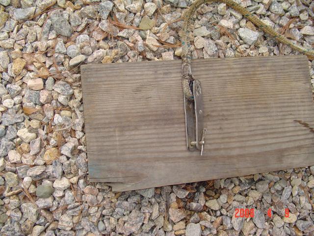

Hi Michelle,
I bought my shackle off Rudy many years ago when I was in his shop. He told me that it was better than the stock shackle that came with the boat, so I purchased it along with a new pendant line and spliced it myself. The shackle is very simple in that it is made up of two stainless steel plates with a small nylon sheave held on by a pin on one end, and a hole through both plates for the rigging pin on the other end. The cotter pins on those shackles will let go after a while as I found out four months ago.

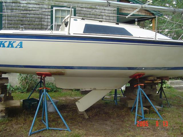

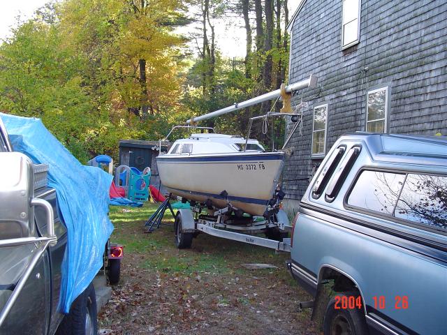

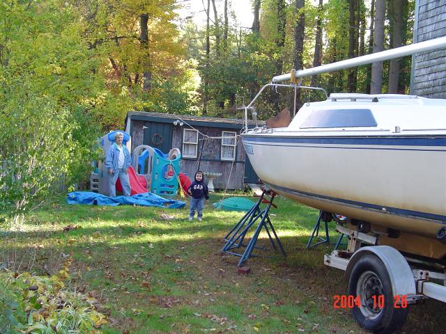

I think that it was back in 2004 when I started bottom painting my boat at the house. I bought four new Brownell's Boatyard SB-3 Sailboat stands and placed them under the stern of the boat and jacked them up. I tied the stern off to a tree in my backyard and pulled the trailer out from under the boat a little at a time. It was easy with the roller trailer but it's very dangerous. Most guys won't tackle a job such as this and for good reason. Today I have a flat bunk trailer and it is even harder to get my boat off it and on to stands. I use about 20 wooden blocks, a hydraulic jack, a block & tackle, a single powerboat stand, and my four sailboat stands. It's practically an all day affair and I'm dead tired at the end of the day. I really hate bottom painting!

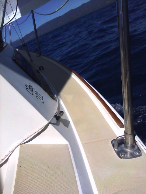

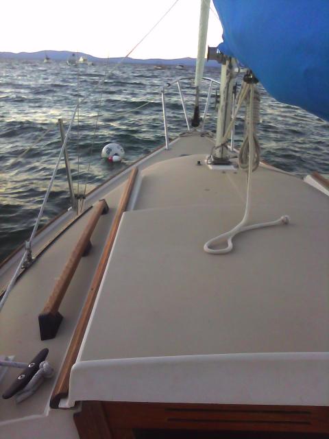

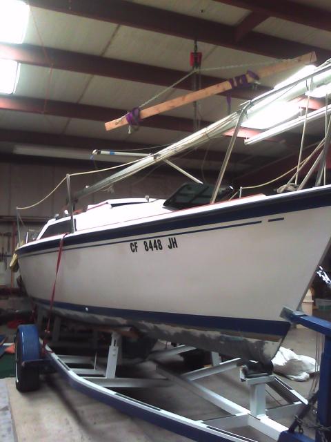

Hi Joe,
thanks for the great info. Here are some pic's from my camera phone:

Michelle,
In the garage picture I can see a chain fall hanging from a beam on the ceiling. This is ideal for getting your boat off the trailer. All you need is to suspend the bow from the chain fall and use blocks under the stern of the boat with four sailboat stands, and that trailer can be rolled right out from under her hull. Even if you moved the trailer ahead and set the bow on the trailer over the axle with the wheels chocked, the boat should be stable enough to safely work on it. Wood blocks can be stacked on the keel board of the trailer to get the bow up higher. They can also be stacked in pairs and criss-crossed on the floor too, which is what I would do. I know that you're not up to doing something like that, but you must know someone who is into rigging or maybe a power company lineman that can help you with it. If you need pics of how I do it, I will send them to you. It can be dangerous but it is doable to the right person who knows how to do it safely. My four sailboat stands can lift my boat. They're not meant to do that, but they can do it. I raised the stern of an O'Day 26 at the club one day with four of my stands for a friend of mine. His boat was on the trailer crooked, the tide went down and we needed to straighten the trailer out.
Your boat is set up a lot better than mine was when I bought it new. I can tell by your mast Tabernacle. Nice boat! Is that your garage or is this where you store it in the off season?

Thanks, Joe!
She was a great find :) The lady who I bought it from was tickled pink that her old boat would be used to teach folks to sail.
Unfortunately, I no longer have access to that shop you see in the photo and no longer have the hoist setup, either.
