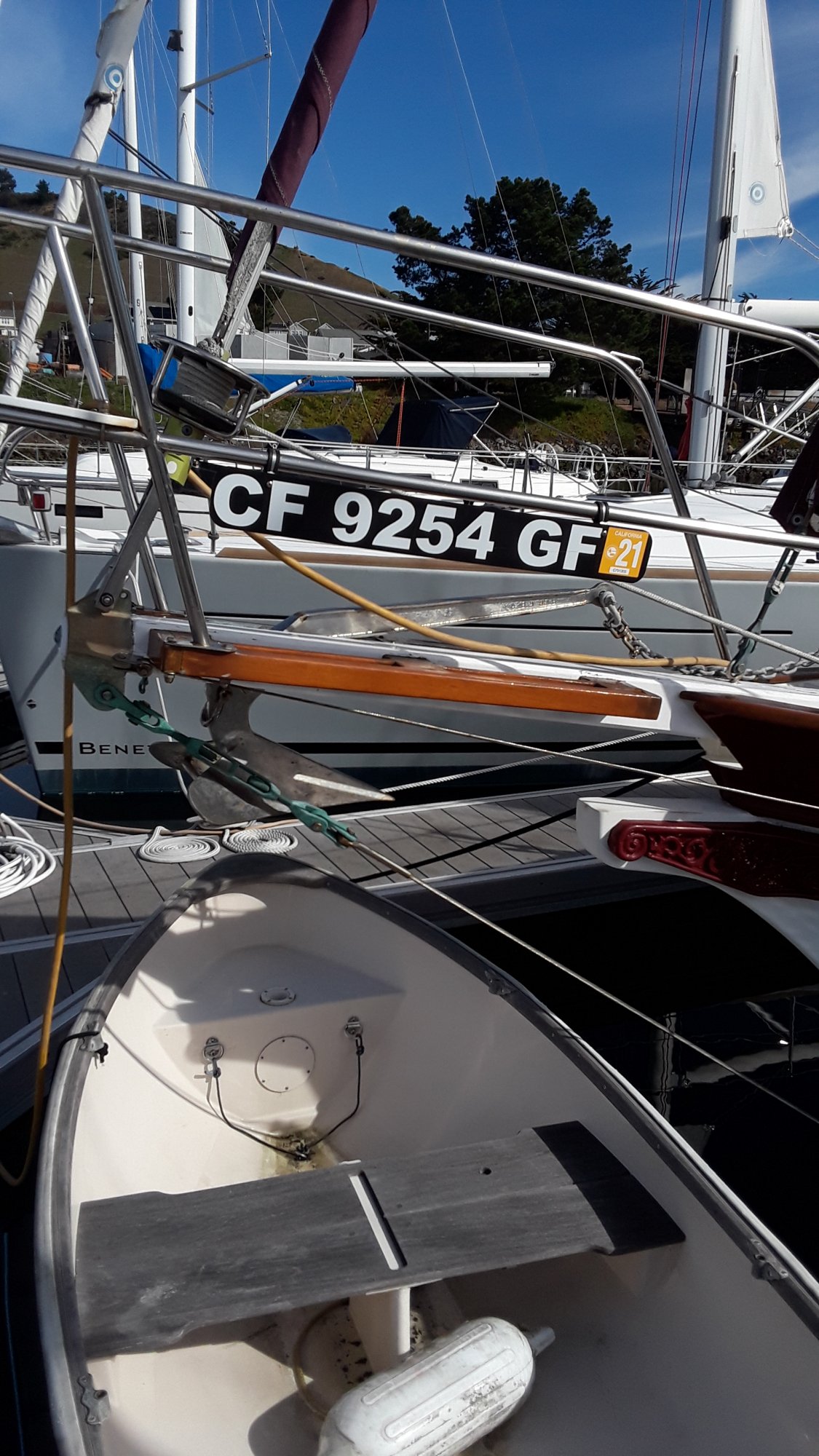

Anyone displaying their boat registration on a placard attached to the bow rail vs. sticking on the hull?
Ayuh. I mounted peel and stick #'s and mounted them on scraps of 1/4" lexan with a few holes to wire tie them on.

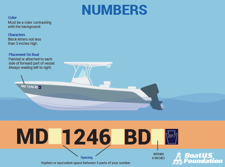

If your original question was about a documented vessel, then federal law prohibits the display of state registration numbers.
Here's what BoatUS has to say:
They are too easily stolen. On my almost new boat, the dealer hung them from the pulpit with good wire ties like you have. First time out in 16 knots, one blew off to Neptune.
