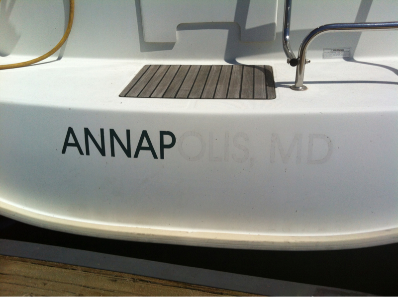

What all is involved in removing and repainting/lettering a new name and hailing port on the side of my boat.
The current name is painted on both sides and of course the old home port is on the transom. I need to remove it all and paint or vinyl letter my new ones. -BCD

One warning is that it is tough to obscure the old name and home port, which will have faded less than the rest of the transom. It may take serious buffing or wet sanding and buffing to remove it to your satisfaction. I can still see the original home port from two owners ago on mine!

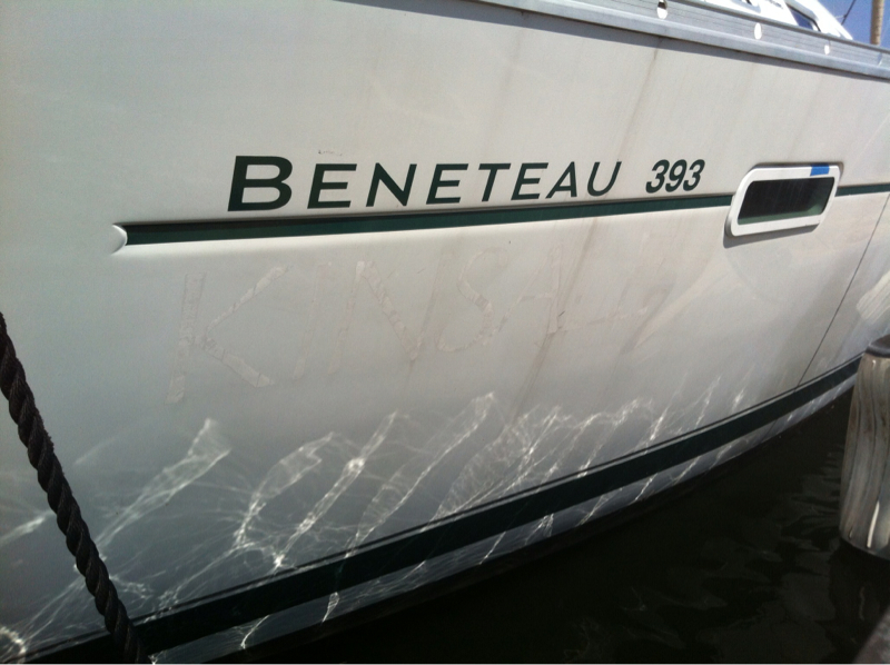

Erase it with a 3M Stripe Wheel. As mentioned, follow up with a good compound buff, and polish to remove the shadow. Maine Sail tells you how.

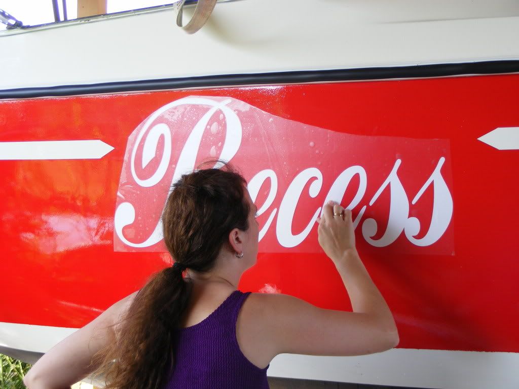

Not sure why you would want to use a local sign shop? You can design the boat letters online so you know exactly what you are getting and at about half the price of a brick and mortar sign shop. I have used Speedy signs three times and have had excellent results and customer service. I once had to call them to let them know I had not received my vinyl letters so they sent me a duplicate at no extra cost. I found my wife had got them out of the mail box and then forgot to tell me. I called to tell them and they said no problem, no charge even though the error was mine. I usually get my letters in three days, but they are only about 200 miles from me.

Ha! The previous owners buffed the transom so much that where the letters were. . .that actual area is now raised slightly. I have 3 previous names and hailing ports visible on my boat. . .with mine painted on top. Though, it did help to verify the chain of ownership was correct and the paper work was good ;)h:
Cool: The raised area is not caused by buffing but from deteriorating gel coat around the vinyl protected area. Most boats that we have renamed in our harbor have the same issue. If someone wants to remove these arevas wet/dry sand paper or rubbing compound are probably you best bets.

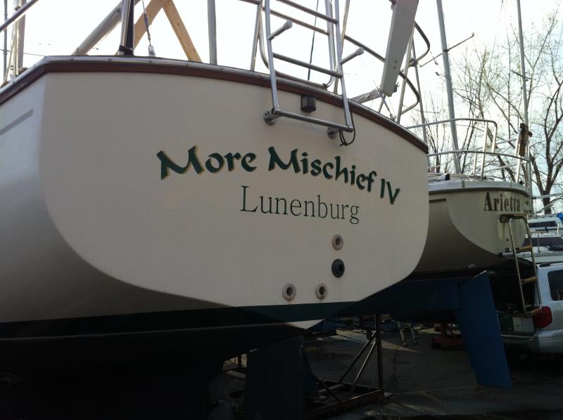

May 25, 2012
46
Beneteau B393 Norfolk
Just an update on this issue. The best way for me to get the vinyl lettering off was a blow dryer and a plastic scraper/fingernail and they just pulled right off. I did have a raised area under all lettering and had to wet sand with 600 grit and some polishing compound with a buffer - worked great for this novice! New name and port are applied and was purchased from www.letteringonthecheap.com. Easy site to use, lots of fonts to choose from.
