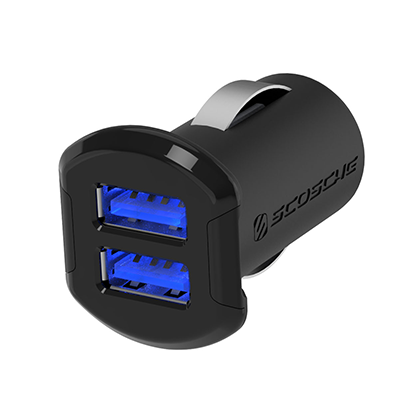

We use a couple of approaches for USB charging and other 12v stuff.
1. We have a good number of 12v cigar-type outlets at convenient places around the boat, and use adapters as suggested by Maine Sail. Works very well.
2. We also have a couple of dedicated USB power outlets using inexpensive 12v-5v power supplies, available at many places such as Amazon and E-bay. We find these usually more energy efficient than the adapters in 1 above.
3. In addition, we have a 12v-12v power supply that runs our "sensative" 12v electronics, such as the TV and Media center. This ensures that these electronics see a good quality 12v source independent of the charging voltage at the battery bank.
Note that our boat has only a small inverter, so we do not use 120v when away from the dock. Even at the dock most of our loads (including computers, etc) are 12v supplied via the 120v battery charger.

No, I figured he was talking about converting the AC outlets to DC ports for USB because there seems to be less desire to run AC appliances on his boat. I'm pretty much in agreement that fewer AC outlets are actually needed, except for specific purposes like the water heater. It seems way to complicated to run an inverter off a 12v battery system just so you can plug in an AC adapter for a USB port when they make those USB ports to work directly off the battery. I don't think I would make the conversion on a Tartan 3800 but I agree with the logic anyway. I also don't stress out if I don't have the latest USB technology. (I guess I'm a bit more laid back - I sail a boat to sloooow down, not speed up :wink:) As long as my phone and Kindle charge up while I'm sleeping, I'm usually good to go. Besides they make those outlet ports with both the circular cigar lighter port and multiple USB ports. That's what I installed in my nav station and it works out fine. If I can use my phone while it's on the cord, what do I care if it's charging at a slower rate. The fixed mount USB port does have the advantage over the insert style in that the insert is just another part to get lost. I prefer to have just a few USB power cords on hand without the necessary conversion plugs that forever are being misplaced.

My O'Day 322 has A/C outlets in the V and stern berths, 1 at the Nav station and 1 in the galley. There is also 1 in the lazzerette. I find them very convenient when I am on shore power. I can plug in a shop vac or a sander for some maintenance, the Keriug for a quick cup of coffee, my laptop if I need to get some office time in.
I also have 12-volt power outlets in the V, at the helm, and in the lazzerette. I carry my iPhone car charger when out overnight so I can charge my phone or iPad. My Serius satellite radio receiver is always plugged to one of the power outlets and my handheld VHF has a "car charger" that I use to keep it fully charged.
I can see having some dedicated USB outlets maybe, but as long as I can get a car-charger for whatever device I happen to have, the 12-volt power outlets work fine. I can always get a USB adaptor to the power outlet if necessary.
