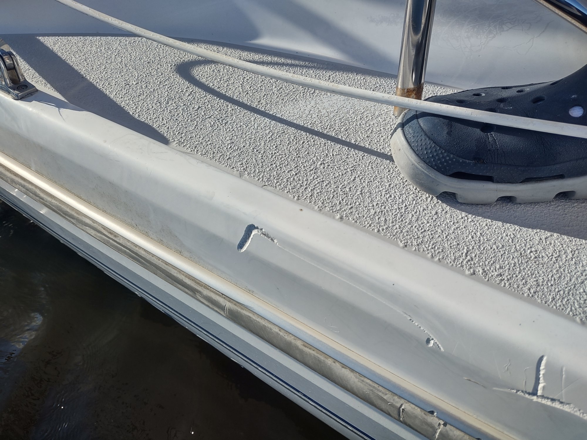

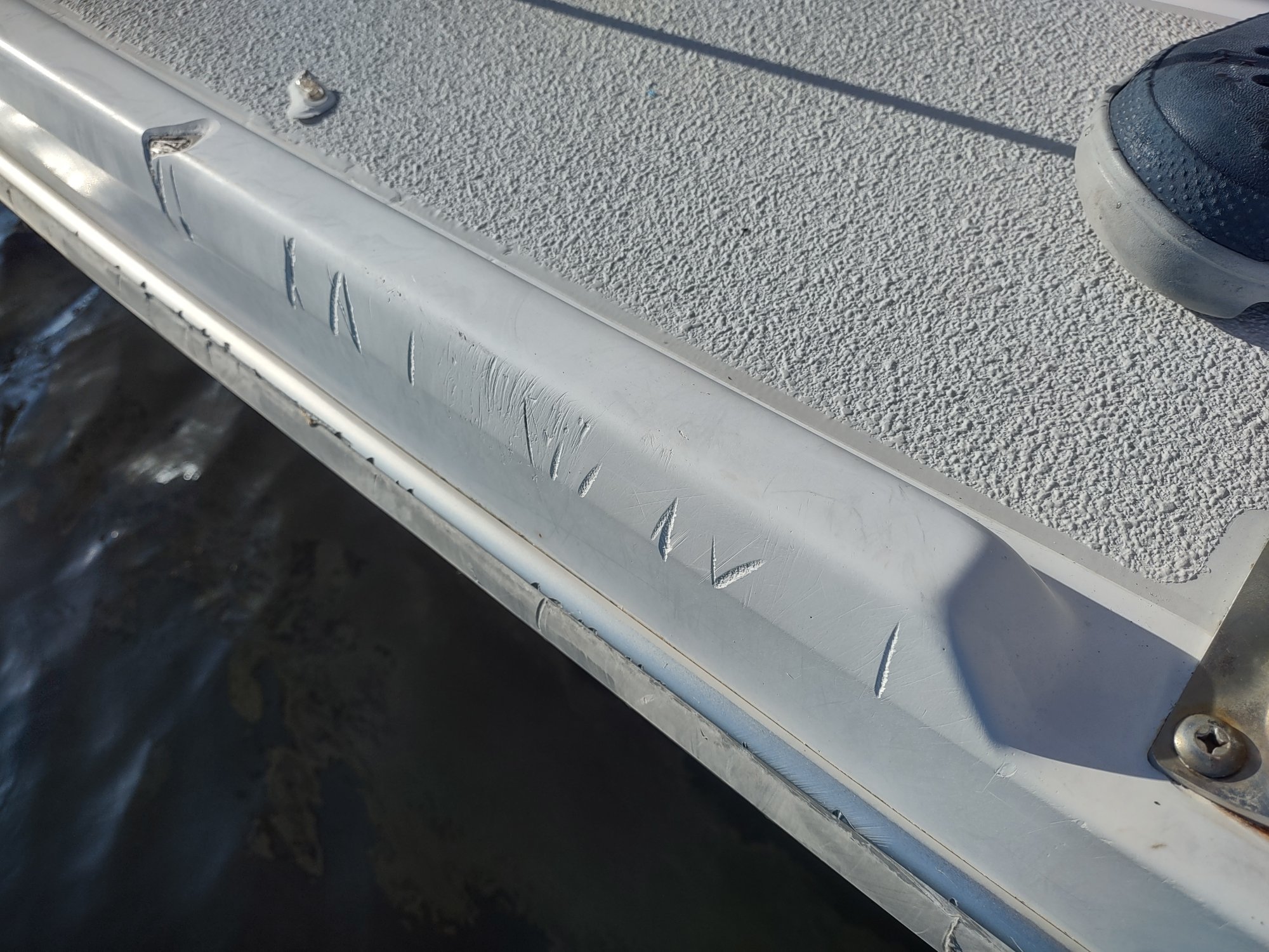

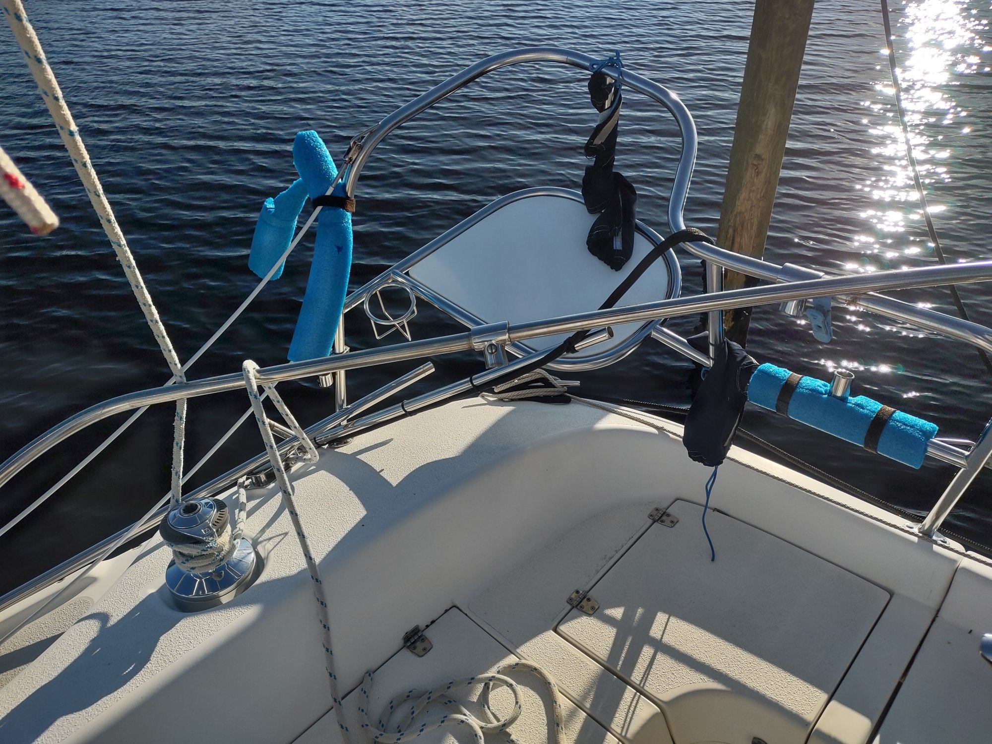

Before the eye, the wind was pretty much dead on the bow (at dock). The boat backed into a piling (when the 3 bow lines snapped) bending the stern seat forward. Then it turned 90 degrees to the right against the piling (as there were still 3 spring lines holding it on the port side) and heeled over wrecking the starboard stanchions, lifelines and gouging the toe-rail (all above the rubrail since it was heeling so much now that the wind was coming 90 degrees from the port side).
Any best tips in replacing the stanchions and stern rail/seats? looks like I can get to most of the bolts from below without too much hassle. may have to cut some of the inner liner to get best access though. Need to find replacements. Pretty unsure of getting exact replacement for the perch seat. Pics to follow. video in the next post.

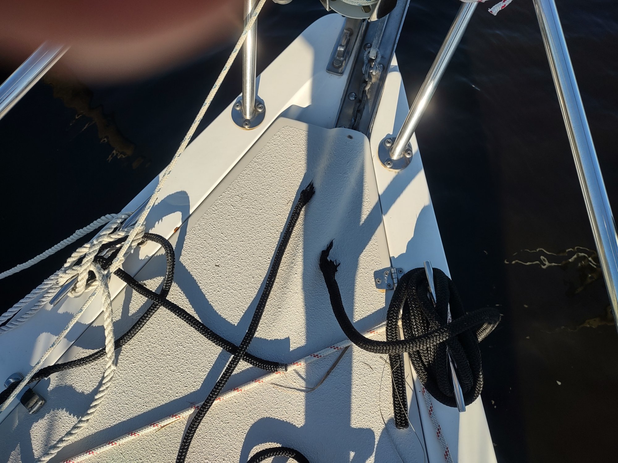

The bow lines which snapped were: a 1/2 inch braided (brand new), a 5/8 inch braided (pretty new) and a 1/2 inch twisted a bit older. The problem is they were too short. pic below shows the snapped ends of the braided ones...

Thanks for the info. A dock neighbor had a dock line part but had them tripled up so only the shortest snapped. Interestingly, it was the largest line.

There is a Railmakers shop in Everett WA. They fashioned new bow and stern pulpits on my boat. Even added seats. Came to boat. Measured. Came back with pulpits and checked on install. Had to make minor adjustment to one side of bow pulpit.
Very pleased with results.

I would highly recommend that boat owners pick up some used fire hose from your local fire department. It is the best chafe gear I know of and it should be quite inexpensive.
When I am dealing with tropical storms of any kind, I pick up some carpet remnants to add to the fire hose. I can't ever remember having a dock line or snub line part when double wrapped like that.

Good insight about the "too short" dock lines. Dock lines should be at least 8ft long so they can stretch enough. Nylon lines will stretch 20%-25% before breaking. So an 8ft line will stretch at least 2ft. That stretching decelerates the boat's movement slowly instead of with a jerk - reducing the force on both boat and cleat.

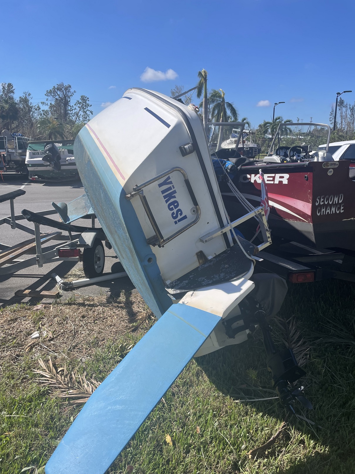

Sorry about your damage! My Hunter 18.5 Yikes! was blown off the trailer and broke its mast about 4 ft above the deck, I'm looking for a 5 ft section of Z-Spar Z145 in order to sleeve the mast. Good Luck with your repairs!
