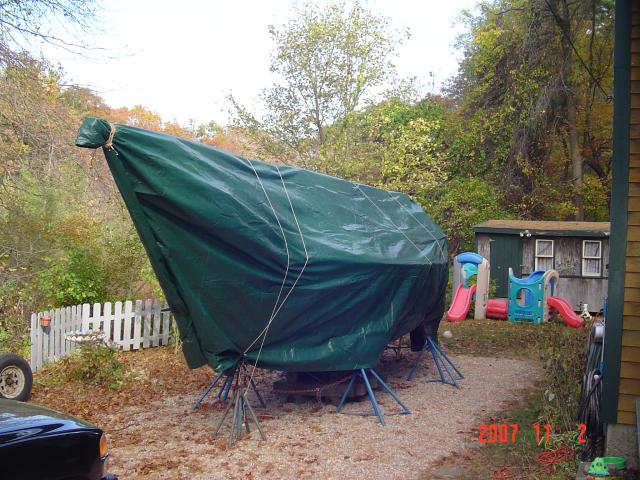

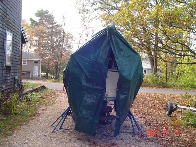

I've been using large polytarps to cover my O'Day 222 for many years and I really never had much luck with them until I experimented with various ways of holding them down without tying them. I used milk jugs filled with water and various methods of tying these tarps and they would always rip on me. Finally, I came up with a way of securing my main tarp without getting rips and tares. What I have been doing is removing my stays and spreaders and wrapping the mast with old pieces of polytarp cut into strips of 2'X 10' or more feet long. I wrap both ends of the mast so that my main tarp has chafe protection. In essence what I'm doing is using the mast as a ridge pole for the tarp. The mast is tied to the mast crutches. Then I spread my 18'X30' Polytarp over the top of the boat and tuck the tarp over each end of the mast and use a 3/8"X5' rope to tie a large clove hitch with half hitches to anchor the tarp to each end of the mast. After I've tied one end I make sure that the tarp is stretched out taught, then I tie the other end. Then I take a 3/16"X100' braid line and tie it off to my trailer or a boat stand near the stern and spiral the rope over and under the boat and tie it off at the bow. At the bow where the two ends of the tarp come together, I take a piece of strapping about 4' long and role the tarps around it and use a carpenter's spring clamp to hold it in place. I leave the stern area of the tarp open a little so that the air can circulate under the cover. That's it. I've gotten about six years out of a polytarp. A canvas is good, but they're a little heavy and the material is pricey.

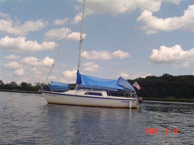

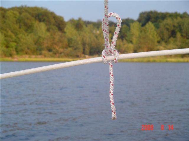

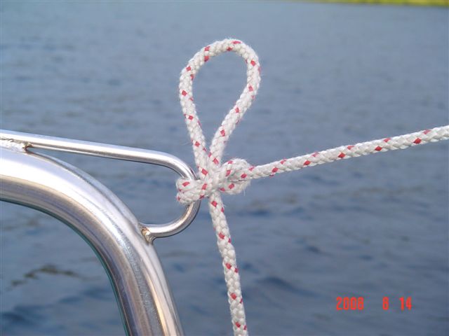

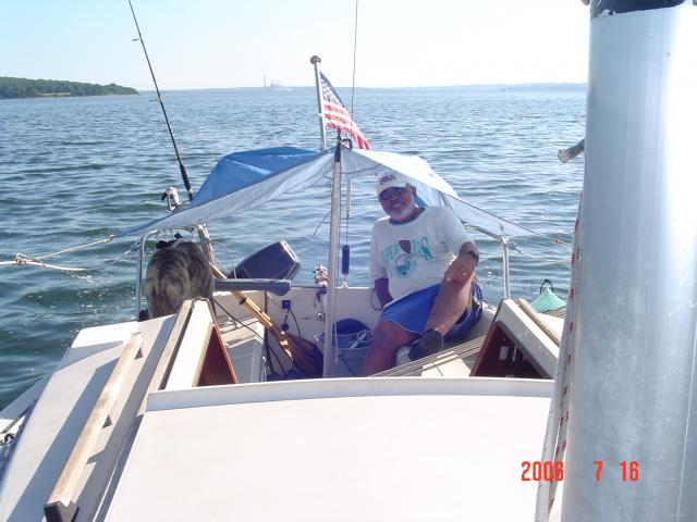

I tried Home Depot and they were too expensive. Up here we have "Ocean State Job Lot" stores and I found a nice heavy duty 18'X30' Polytarp for under $55.00 and bought it. Harbor Freight may have a good buy on these tarps also. For sun and rain, you can't beat a polytarp. I've been buying the Ozark Trail blue polytarps at Wal Mart and using them for awnings. They have plastic reinforced corners on their tarps. I bought an 8X10' to go over the boom and a 5x7' for over the forward hatch for when I anchor in the cove in the hot summer. You can't beat them. They make the boat so cool and also keep the morning dew off the deck when I get up in the morning. I bought some 3/16" braid line and cut pieces to size for the tarp. Also, I bought a grommet tool with 1/2" grommets. The grommets on the tarp are never centered right where I tie off to the mast and end of boom, so I install the grommets so that the tarp can hang even over the boom and tie the tarp off to the lifelines. I use quick release hitches on these tarps so I can remove them in a hurry if I have to. The last pic is my "poor sailor's Bimini Top." My apologies for Penny's rude behavior. She likes to moon the camera. :D

Thanks for the tips. We live near both Harbor Freight and Wally World. Also appreciate the quick release knots. I use them all the time but my "knot challenged" husband does not.
