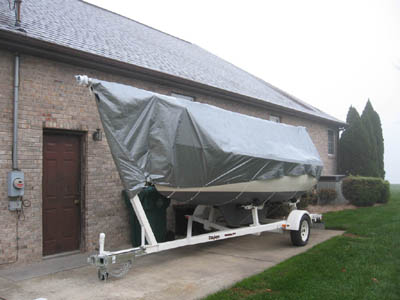

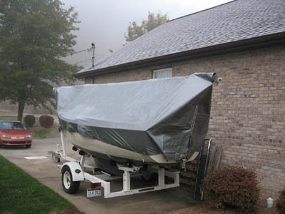

I have had good luck using HD silver plastic tarps. Use a small soldering iron or Weller to burn small holes along the edge, shape it the way you want and lace it together using light nylon flag halyard type line. You can even use discarded tarps and be "green"
