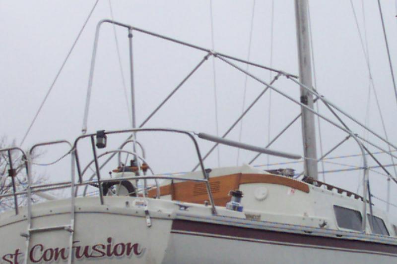

My personal opinion is that any boat with a balsa cored deck should be completely covered in during the freeze thaw cycle. Covers don't need to be expensive. I have used 1x3 and 6 mm plastic but I really hate the thought of snow and ice melting and freezing on that deck all winter.

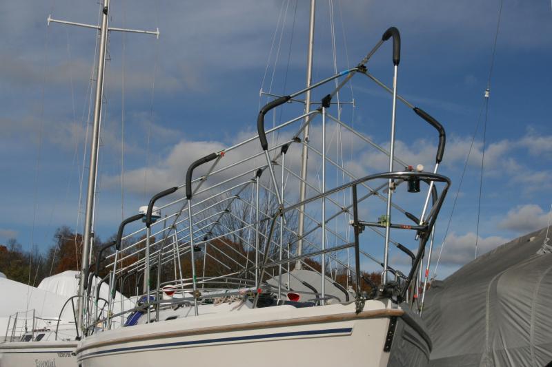

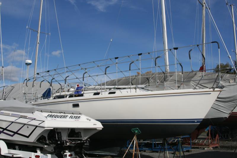

Greetings. I just finished a KK installation and I used their tarp. A couple of points to consider: Cover the entire boat. this will not increase the cost by a significant amount and if you make the ridge continuous/horizontal from bow to stern, may be easier to build and easier to cover than with sloping ridge. The tarp material they supply in conjunction with the KK clips is easy to install. I made the heigth of the rib legs high enough to enable me to move around the side decks somewhat easy as I need to work on re-sealing deck hardware etc. Bottom line, if you follow their comprehensive installation recommendations, its straightforward and cost effective. The KK folks are great to deal with.

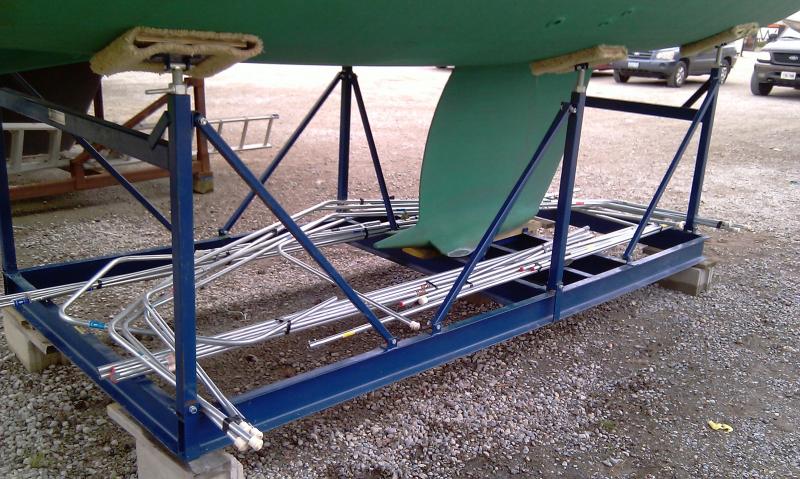

I use the Kover Klamps system and it works well. All you have to do is bend 3/4" conduit 60 degrees. I borrowed a pipe bender from work to do that and drew a 60 degree angle on a big piece of cardboard to measure the angle. You also need a pipe cutter. I also bought a heavy duty (silver) tarp from tarpsupply.com.

Alain and Pogo, those photos of the frame systems really help me to understand what needs to be done.

Ward. I installed the tarp last week but forgot to bring the camera with me. KK has videos on their site that show the installation of two different tarps that illustrate tarp installation. They also supply a dvd with thorough instructions. I thought of buying a less expensive tarp using the KK clips however, their tarp, at 25 cents/sq ft., is very reasonable for a decent quality tarp. I have used different types of clips in the past and the KK clip is by far the best.

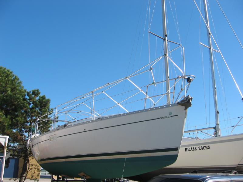

I also use the Klover Klamps and a Poly Tarp. It lasts about 3 seasons before you need to replace the tarp at about $136.00 for a 35 foot boat.
I didn't use as many cross pieces as Alain. One at each stanchion. The tarp is translucent and allows my solar cells to keep the batteries charged.
Attached is a pic showing the boat covered. I also use the Klover Klips which are the easiest tarp attachments around. They work even at -20 degrees.

Thanks for posting those photos. I'm about half way through making my frame. Your and alain's photos helped to figure a few things out.

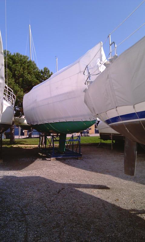

I use a full canvas cover which was custom made for the boat. Its on its ninth and probably final season before replacement. The boat stores with the mast up and I use the boom as the ridge with a vertical support at the end. Forward, I use a 2x6 from the mast to the anchor roller, no need for the elaborate framework that others seem to prefer.The canvas was designed to go around the stanchion bases and over the toe rails and ties down to the cradle. It has a zippered opening at the stern to access the cockpit and cabin if necessary. The "roof" pitch is steep enough that snow load does not accumulate, and with even the 239 inch overall snowfall last winter it was not a problem. The overall cost of the canvas spread over nine seasons, including maintenance repairs is still considerably less than shrink wrap, environmentally more friendly, and seemingly less suseptable to wind damage.
