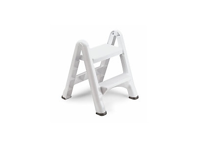

How about a small folding step stool that you can lash to the deck or stow below when you are underway?

For away situations a milk crate works pretty well and doubles as storage away from the dock.

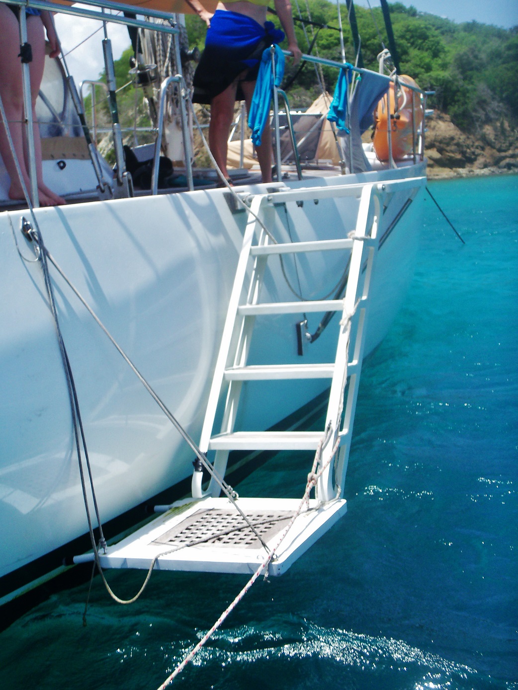

We are searching for a side accommodation ladder, like the ships use. A far easier way to board a high freeboard boat,especially for us older folks and those with big dogs. They work at the dock and at anchor.

Actually, I can get them made down here in either stainless w/wooden steps or alloy for about us$3500 IF I can make an order for 10 or more.
The ones from Marquipt start at around us$7500 plus extras. Were I to hit the lotto, there are a few companies that make some real beauties in carbon fibre that are strong and light as a feather (15k+). Until then even $3500 would be expensive though possible, but it would probably add a fair few years to my sailing adventures. Stepping out of the dink onto a nice platform and walking up a few stairs just seems so civilized, doesn't it?

Preliminary discussions with several metal fabricators down here were for a top and bottom platform, 5 stairs (I think we could also do 4), the bracket to keep the upper platform level, securing points for the rigging on the lower platform, stanchion sockets (no stanchions) and cleats for the dink. The actual attachments for the upper platform to the boat (2 brackets) would not be included as each boat would have to do that as needed. It would fold up and lay flat against the lifelines as in the pic of the S/S one below.
Of course, if I had them produced down here (under my supervision) there would be shipping, but that's really of little consequence. I had a 77 gallon barrel (about 200#) sent to St. Lucia as LCL cargo and it was $167.00 for the surface freight.

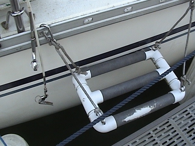

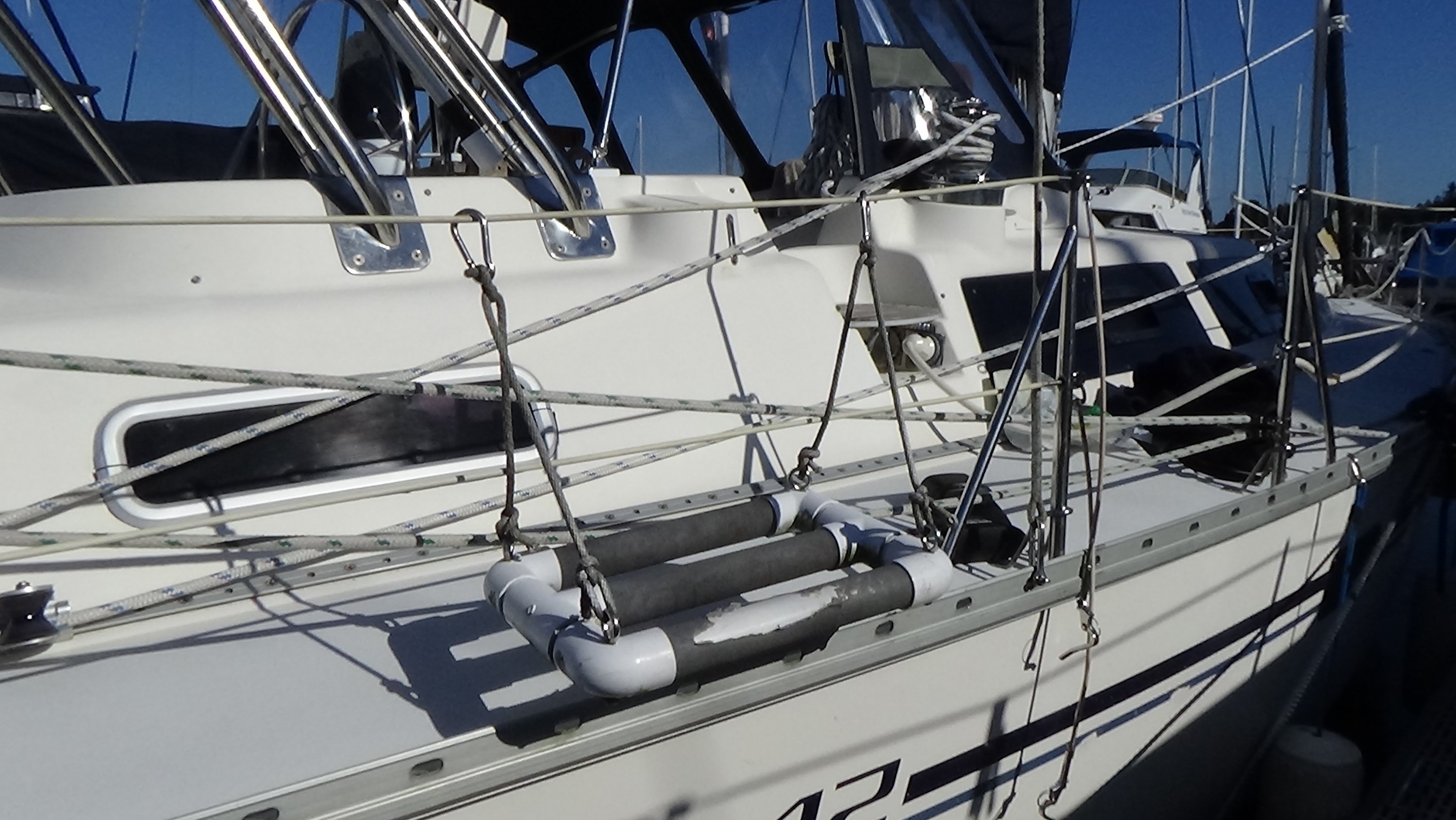

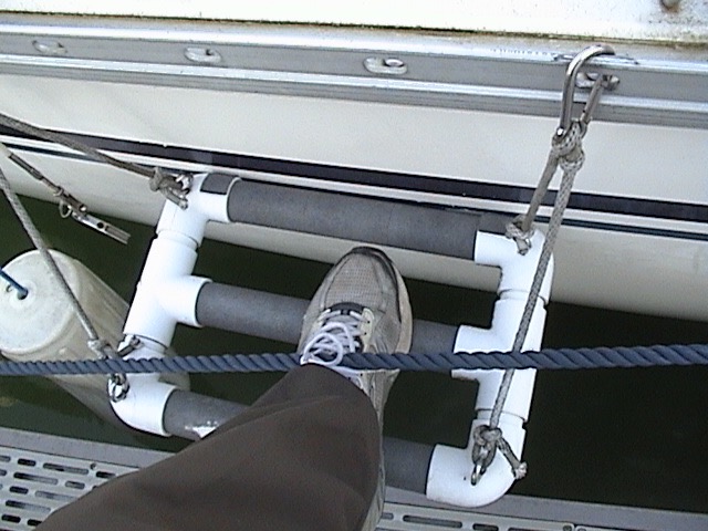

We have one like this for use at the dock when traveling. Folds flat so is easy to stow. Be sure to tie it to the boat or pick it up when leaving the boat. We've had to chase ours after the wind blew it into the water. Also, keep it out of the sun as much as possible. West Marine < $20.
We use a white one but tie a lanyard on to keep from losing it in the drink. I also built a single step hanging from the toe rail. When the dock is low, we use both. When coming in the Admiral stands outside the lifelines on the toe rail step and just steps off onto the dock lines in hand. (Except at Roche Harbor where the dock is almost level with the toe rail.)
Ken
