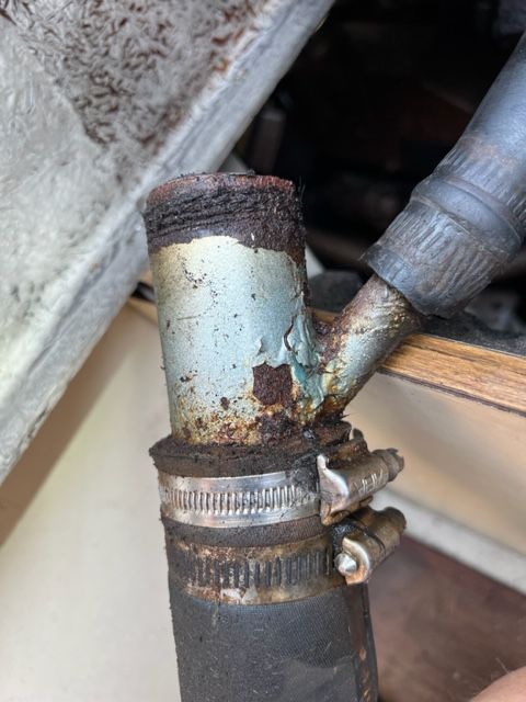

So it’s the 4th weekend and motoring up the ct river we get ugly noise and smoke. Open the hatch and see that the exhaust piping has broken clean off just above the custom piece of the Y connection. We limp into a nearby harbor, but at the end of that two mile run, I have lost about half of my power. I know how to replace e the exhaust as I have done it before, but can anyone tell me what the power loss means?

The Y connector you mentioned, is this the water injection fitting? Do you have a photo.
One possiblity is the broken exhaust reduced the back pressure on the exhaust system which may be part of the reason for the power loss. It is also entirely possible that the two events, power loss and exhaust failure are unrelated.
Some more detail and photos would help.

This is a Universal Marine M12 Diesel (Kubota base tractor engine). The photos showed where the water injection fitting (Thanks DL for reminding me of the name) broke at the first elbow above. As the rest of the awful plumbing (not stainless, but rather black pipe) was so corrroded, I accessed by extensive tool kit and pulled everything off all the way from the water muffler fitting (large rubber hose you see) to and including the flange at the header. Thanksfully with some WD40, I got the 3 studs off. So after I wrote last night I am thinking why the power loss and reminded myself we ran the motor for 45 minutes with awful smoke trapped in the engine compartment. Accordingly, I thought the air filter must have taken a lot of smoke and soot an that tine intake was probably getting 75% smoke and 25% air or worse. I pulled off the filter canister and the mesh screen and foam filter and I have never seen something so awful, foam totally soot filled. Cleaned all and put in a new foam. So now the question modified: Is the bad or no air the engine was getting enough to leave it down on power? I am guessing yes, but the previous time I had bad exhaust problem I got a warning with light soot only from a small perforation. Thoughts?

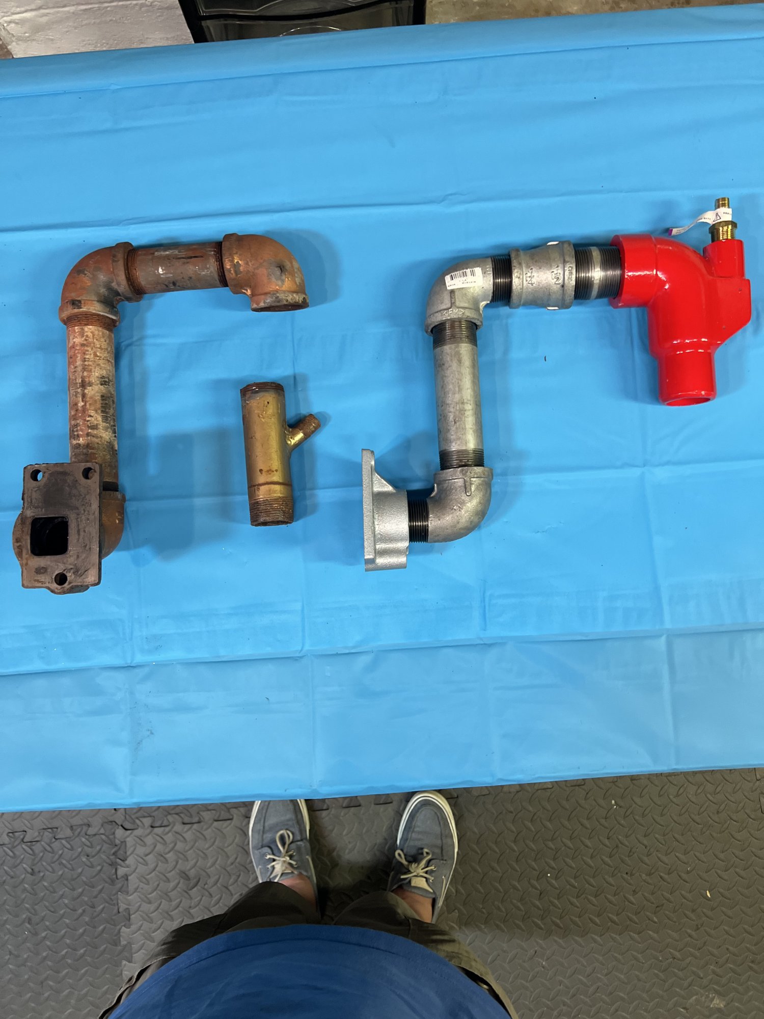

This saga ended yesterday when I got the part from Westerbeke. Large Northeast distributor Hansen did not stock and forget about finding it at a dealer, but Hansen should have had this. (The Hansen guy said, "just change it every 5 years", ridiculous when you think about it as it should have been ss in the first place and yes, $250 for SS would be fine with me instead of crappy for $74.50. And the Hansen guy put his foot in his mouth as, if all the boats that use this nipple will break it every 5-10 years, he should have had the bloody part in stock!)). Just shameful how crappy this part is. Cannot say much for O'day using black iron for the rest of the system, but it lasts longer than this nipple and can be found at any decent plumbing supply, 3 elbows and 3 nipples. I am now having the injection nipple made for me custom in SS. Those operating in salt water that do not want to swap out in 5 years or break in the middle of a voyage should either stock the nipple and the pipe pieces on board or get the part made in SS as I am. Lesson learned for me, For you all, maybe look at when that part was last changed.

Black iron pipe was used for injection elbows by more than just O'Day, Sabre also used them back in the 70's and 80's. When mine failed, I purchased new pipe at the HW store and had the welding class at my HS weld it up. I don't remember what the cost was, but it was pretty inexpensive.

Black iron exhaust risers can last a long time, it's usually the injection elbow that fails. I replaced one on my Catalina 36 with Universal M25. I had a plumbing supply place cut and screw new iron for a new rise, and purchase the elbow, from Hansen, I think.
Stainless is better for the injection elbow, of course.

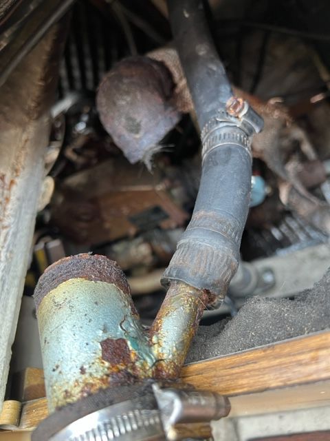

I got super lucky when by chance I was working (cleaning) in the engine compartment. I had jammed myself into the lazarette, trying to clean the other side of the engine compartment when I knocked the old (identical to one in the OP's picture) water connector and black pipe. It just disintegrated!!! After separating the flange from the manifold I tried separating the flange from the black pipe. Sure sounds simple. Never happened. I could not budge the sucker. So I bought a new one and a new elbow with the water injection port from Discount Marine Source. Put it all together and now I rest easy.

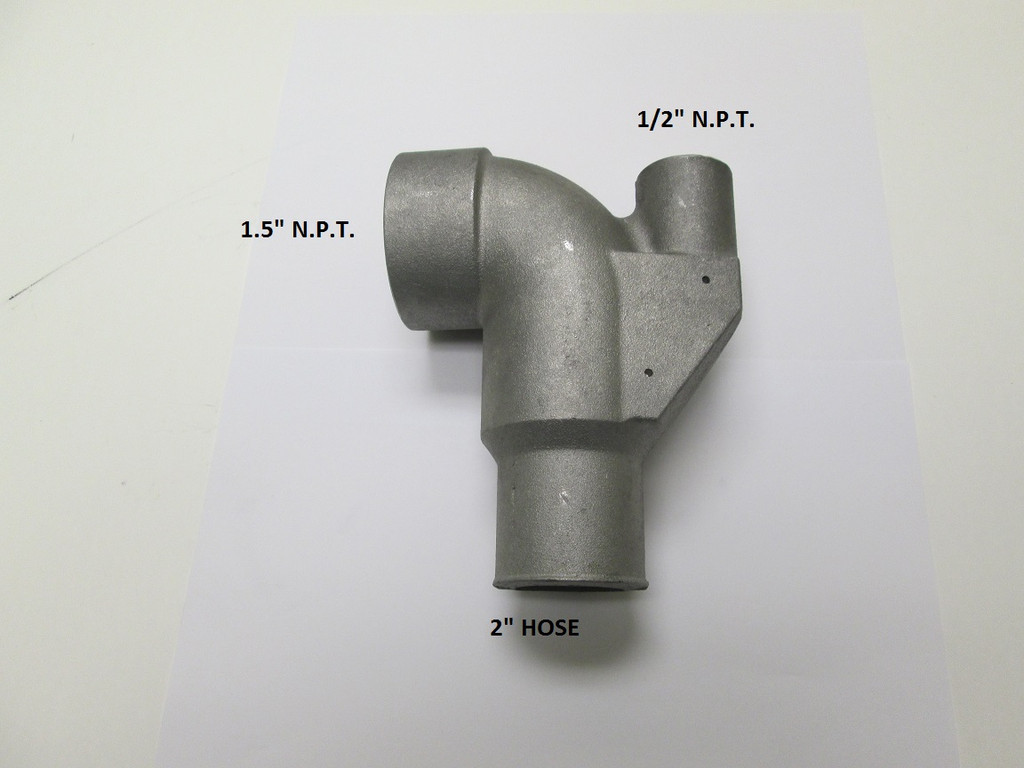

Any idea what the red mixing fitting is made of ? Almost looks like some form of ceramic coating which should last forever and a day, even in that environment.

Here is one unfinished. Looks like it's casted. Maybe a mix of iron and some other metals. I can't say for sure and the sites I looked up don't give any information.
