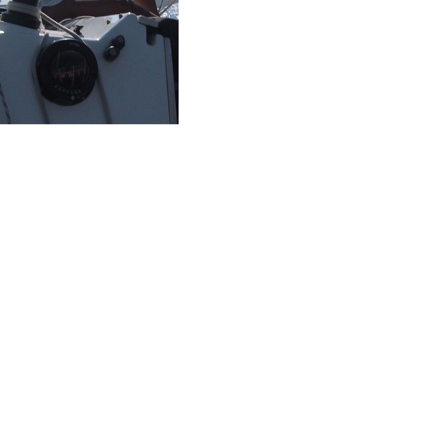

Rick Engel
Cam cleats for Jib sheets
Ron: I really liked the look of your new Powercleats for the jib sheets. I am anxious to hear how it works. This spring, I followed Harvey Small's advice & installed cam cleats on the cabin wall close to the top of the hatch (he has posted pictures on this site). It was a bit tricky putting an anchor plate behind them, but I managed to get it all installed & have been extremely happy with the result. It allows us to use the winch in strong winds, & to make regular adjustments from the windward side of the boat. I'll try to post a photo. Rick

John Pollitt
Cam cleats
My '95 came with the cam cleats installed as in Rick's photo. I had thought they were OEM, as the PO didn't seem the type to add much. Standard or not, they do work well. The only problem I have encountered (and that is singlehanding)is getting the sheet in the cleat when there is a lot of tension on it. Not a problem though for someone who is just doing the sheeting of the jib, as they are at a good angle. Adding an inch spacer beneath them would probably fix that slight inconvienence (emphasis on slight). There was a good article on Sailnet recently about running lines aft from the mast. It's something I would like to do myself, to have the reefing line and vang run to the cockpit. Fair winds, John
