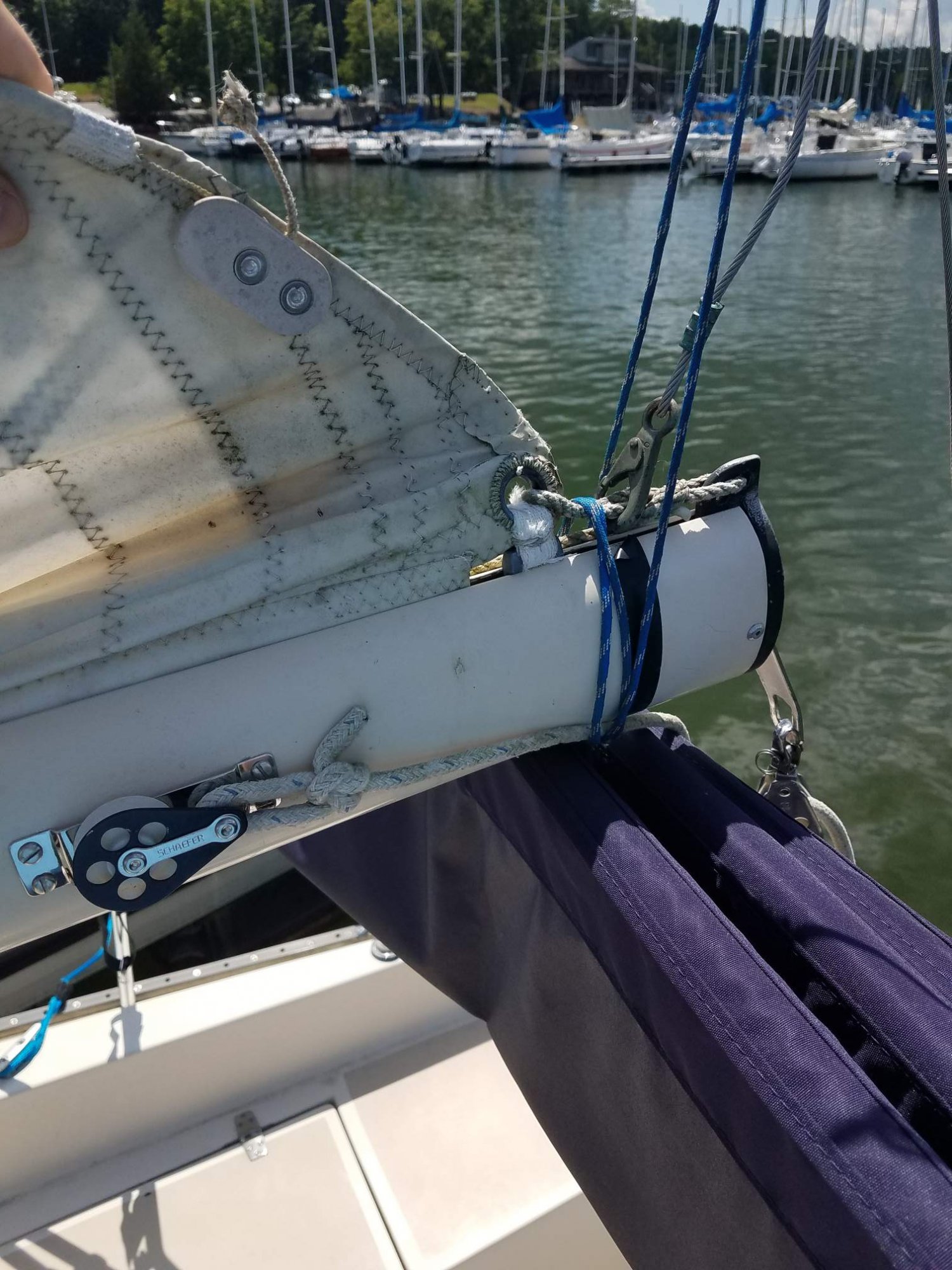

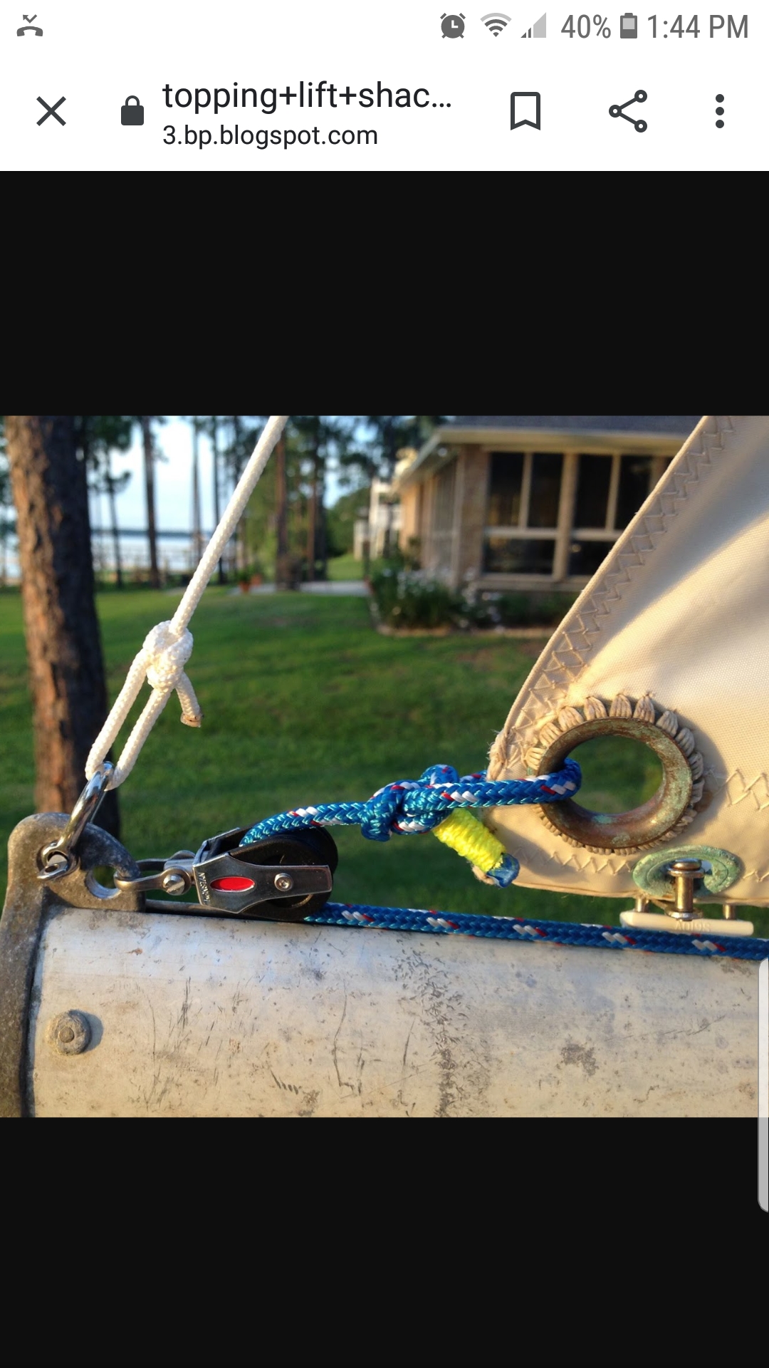

Hi, everyone. I have a 1981 O'day 22 and the outhaul as supplied is lackluster. No block was used and simply feeds through a hole at the end of boom and then ties to a cleat on starboard side of boom. The first pic I grabbed off the Web for inspiration. I was thinking a swivel block but am unsure which size. The second pic is my boom which has two holes. The end hole would be for my topping lift and there is a second hole hidden that i would use to rig outhaul. My line is 7/16". So, when a block states a maximum say of 7/16" line, would that be appropriate or should I look for one with a little bigger sheave size such as 1/2"?

I would say if it says 7/16 it is OK for 7/16. In the first photo you could get 2:1 mechanical advantage if instead of timing to the clew you ran it through the clew and tied it off at the end of the boom.

This is what I was thinking of in previous comment. You end of with 4:1 purchase.. but to minimize friction so it will release smoothly you'll need to use small diameter dyneema single braid rope... 1/8' diameter would be ideal . The forward, handled/cleated section can be regular polyester double braid 1/4" rope. It'll probably work okay with all same size stuff.
But wait! Before you get started, you'll want to get things cleaned up at the end of the boom. The big cheek block in the picture is for your reefing line. Whatever else you have... like that clip for the pigtail...is that blue line the topping lift? if it is... don't wrap it around the boom like that... and also, you don't need that wire pigtail if you have a proper topping lift... so cut the damn thing off. Then start saving for a rigid boom vang so you can get rid of the pesky topping lift altogether.
Okay, sorry about the mini rant... Let's continue.
If you can't find a "lance" cleat... a jam, vee or clam cleat with a fairlead to keep the line captive will work...they're very inexpensive. Like I said, all the friction will be in the back where the line goes through the cheek block up through the clew and back to the eye at the boom end. You should be able to fix the line to the eye with a figure of eight knot, to keep it from pulling through. I would bring the cleat forward about 40% of the boom's length, so you can adjust it when it's swung out on a reach. If you leave it at the very end you won't be able to reach it unless the boom is inside the cockpit area. For attaching items to the boom, I'd use self tapping SS screws that you've dipped in anti corrosive compound for the thin walled boom.
Finally, I just want to remind you that the small line diameter size isn't going to be uncomfortable like it would for a halyard or a sheet where you're winching and hauling all the time. The adjustments are much smaller and certainly not as frequent. The most important thing on a multi purchase outhaul is to reduce friction.
The way the block is setup in the first photo, it is just a turning block, no added mechanical advantage.
This picture shows an ideal 4:1 advantage because the clew acts as a mechanical block of 2:1 plus the mechanical 2:1 advantage phrf the floating block. The cheek block attached to the end boom is another turning block that offers no mechanical advantage.
The line going through the clew grommet, of course, adds more friction than a free rolling sheave in the blocks. So, you don't actually get the full 4:1 advantage. Should be pretty good though.

A picture is worth a thousand words. So the line going from the end of the boom to through the clew is nice slippery dyneema and can be thin. The second line to the cleat can be thicker and softer nice on the hands.

Mine is similar to this one on stingy sailor but I have a cam cleat just below the rear block on the boom.
