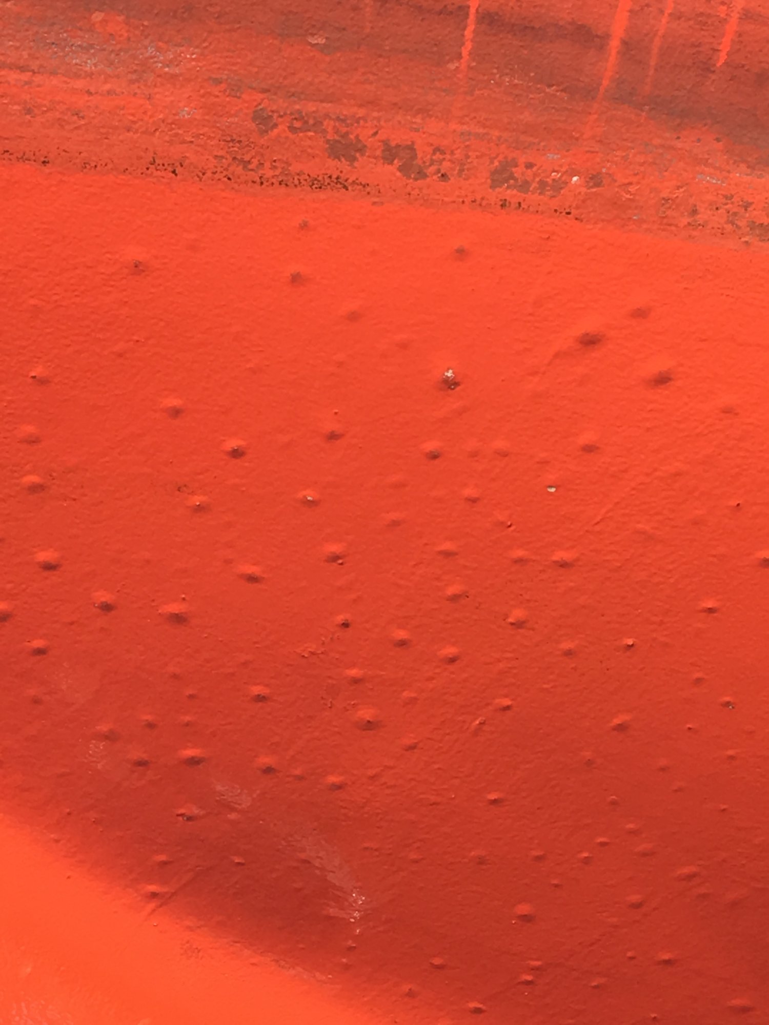

Later that day, and the next, the blisters started to appear.It was awful. I was distraught.
Kelly, one of the many helpful people at the marina, told me: All boats that live in the water have blisters. Fix the big ones. Apply Interlux 2000E epoxy primer. Paint bottom. and resplash. I had lots of pimples. One big one that was six inches in diameter, down to the lead, maybe 3/4" thick. Fixed.

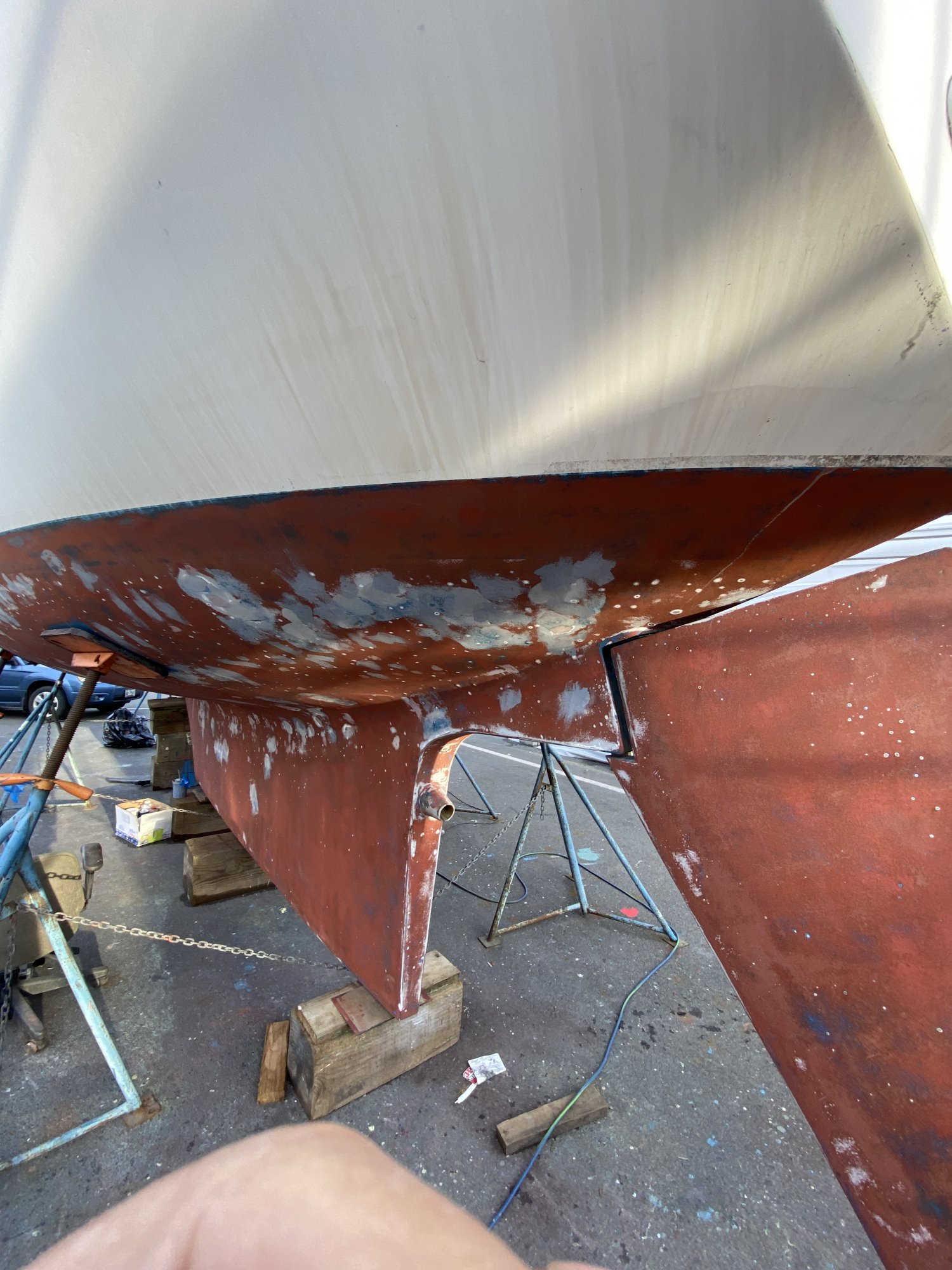

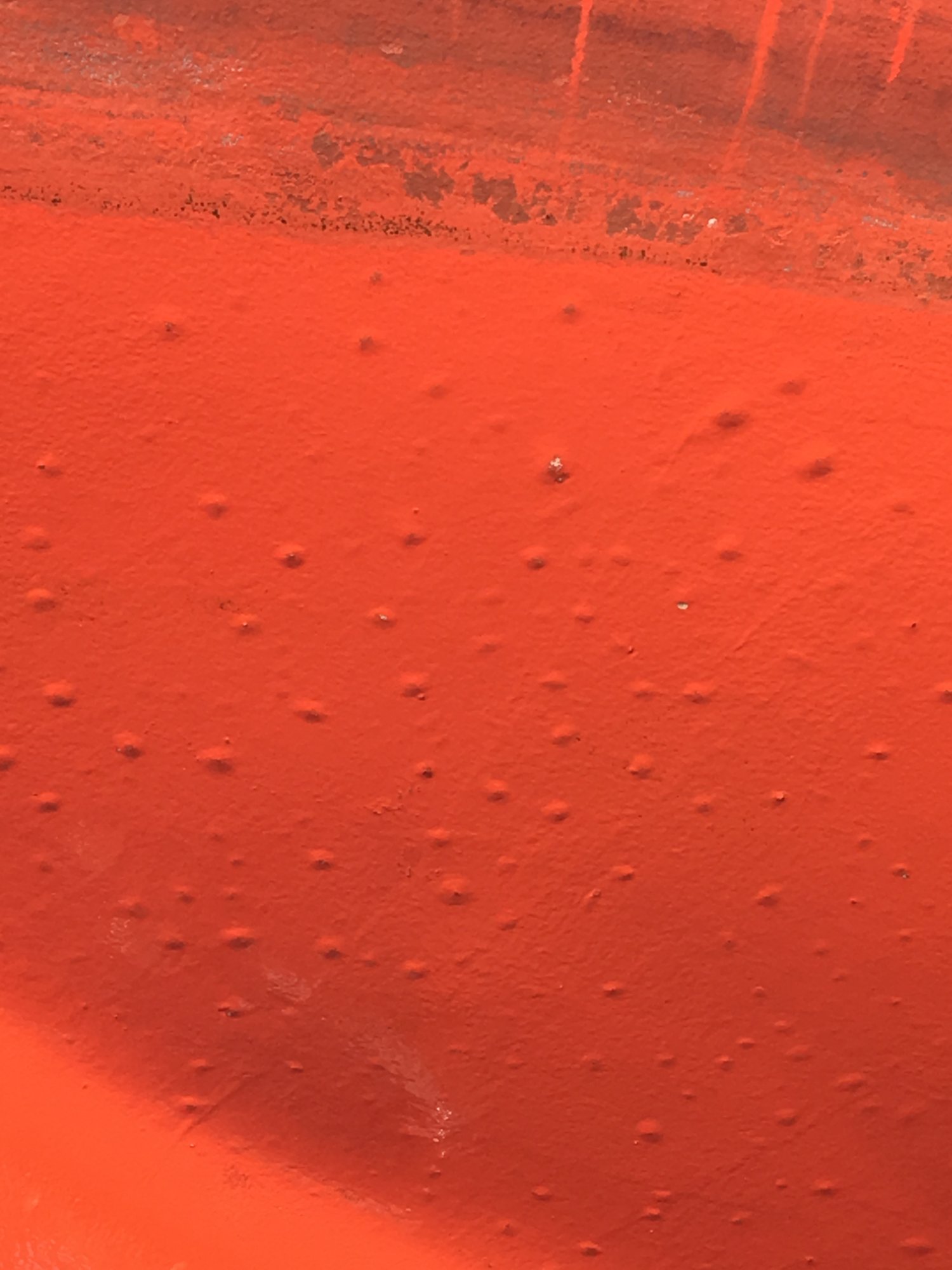

My boat lives in the briny waters of our Port of Everett Marina 24/7/365. I had her Hauled Jan 2018.

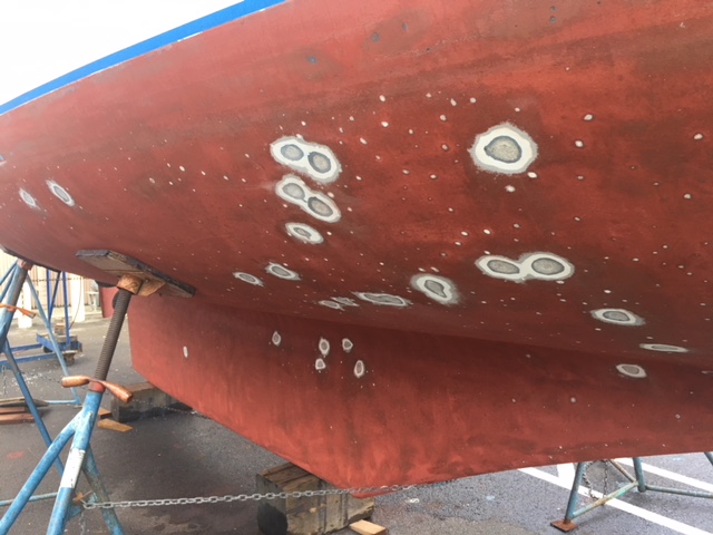

Here bottom had blisters. They looked like this.

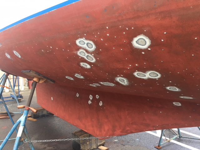

When sanding the larger ones the bottom looked like a patchwork quilt.
Siting on the hard the moisture drained. The excavated blisters were faired with thickened epoxy. Then sanded fair.
Painted over with a barrier coat and then bottom paint.
Ready to splash in March 2018.

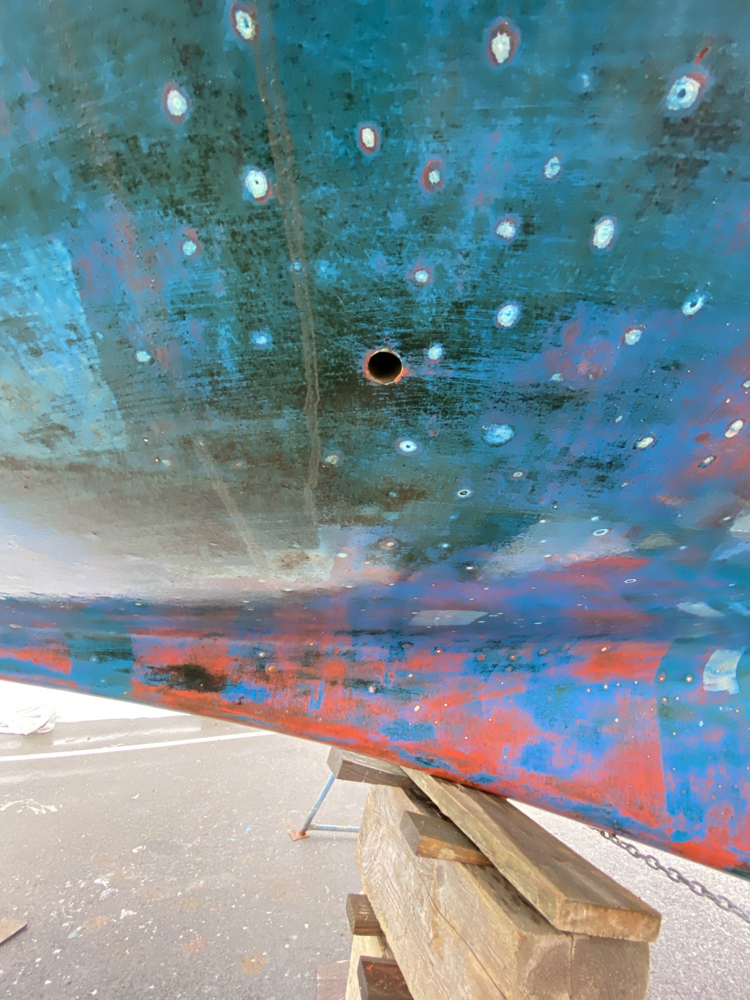

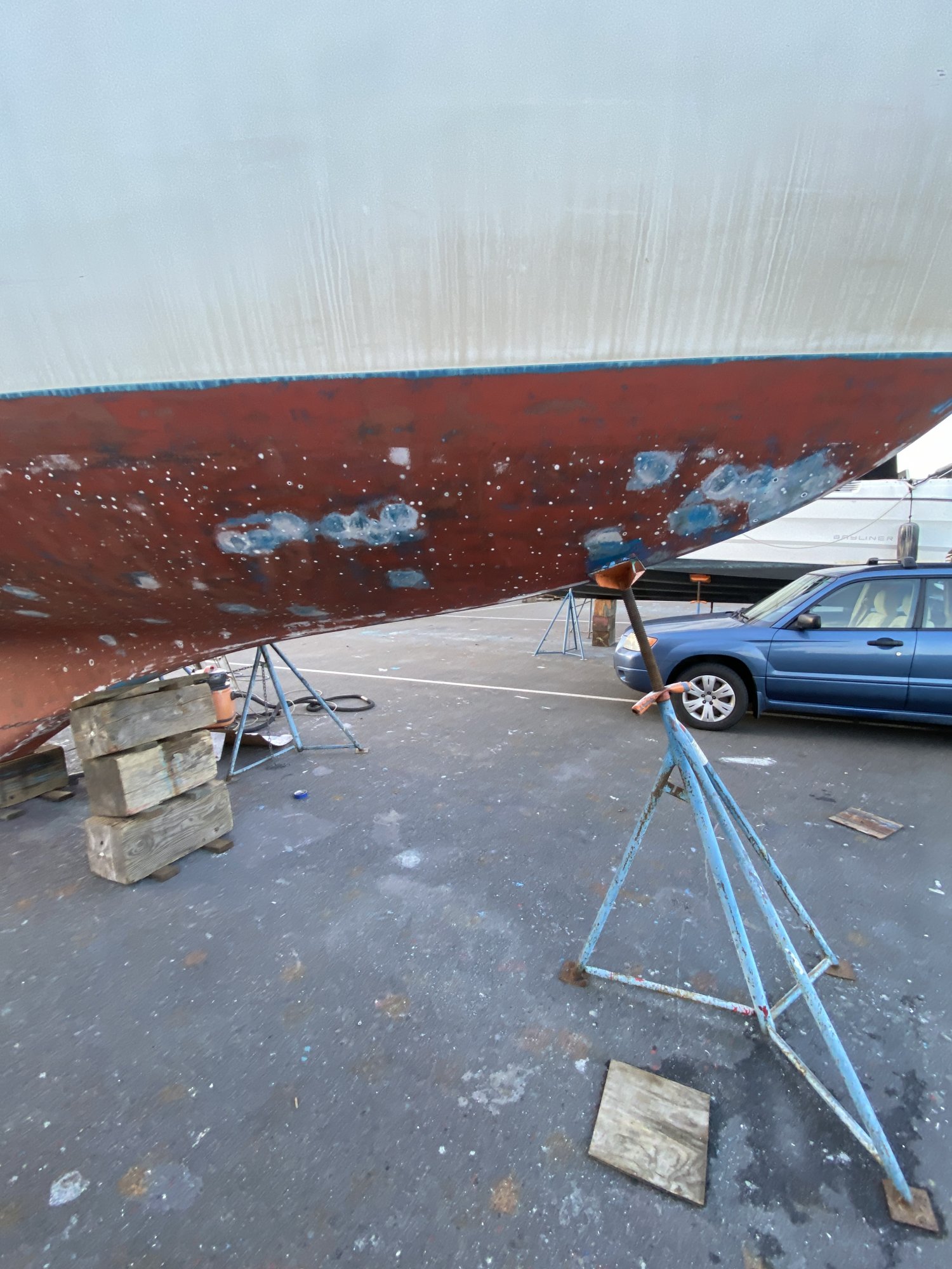

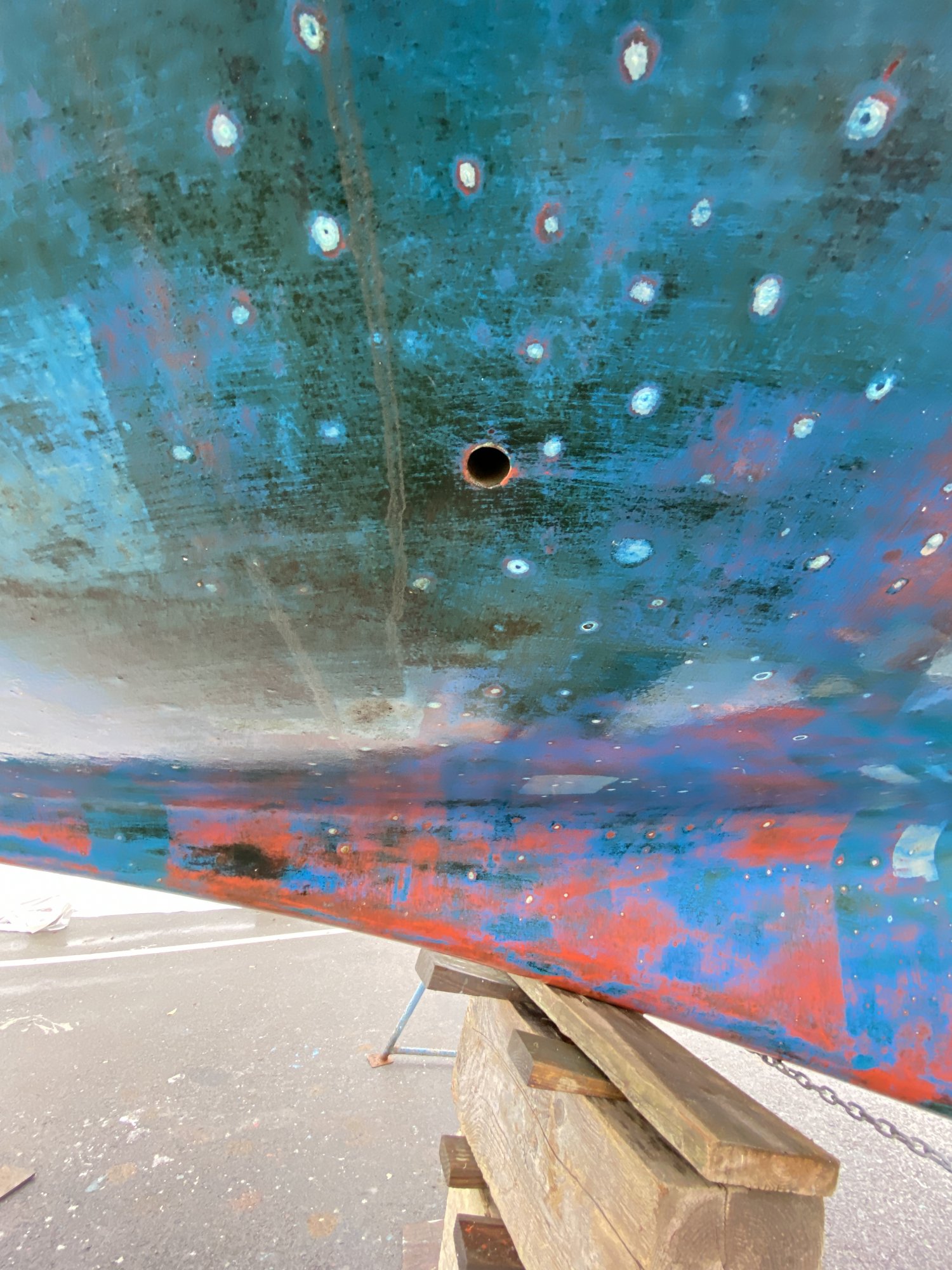

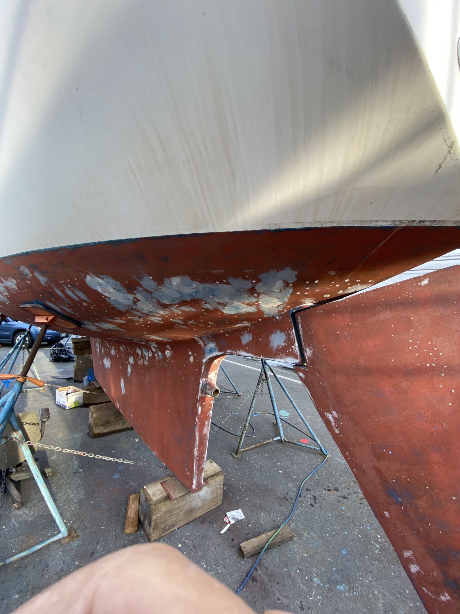

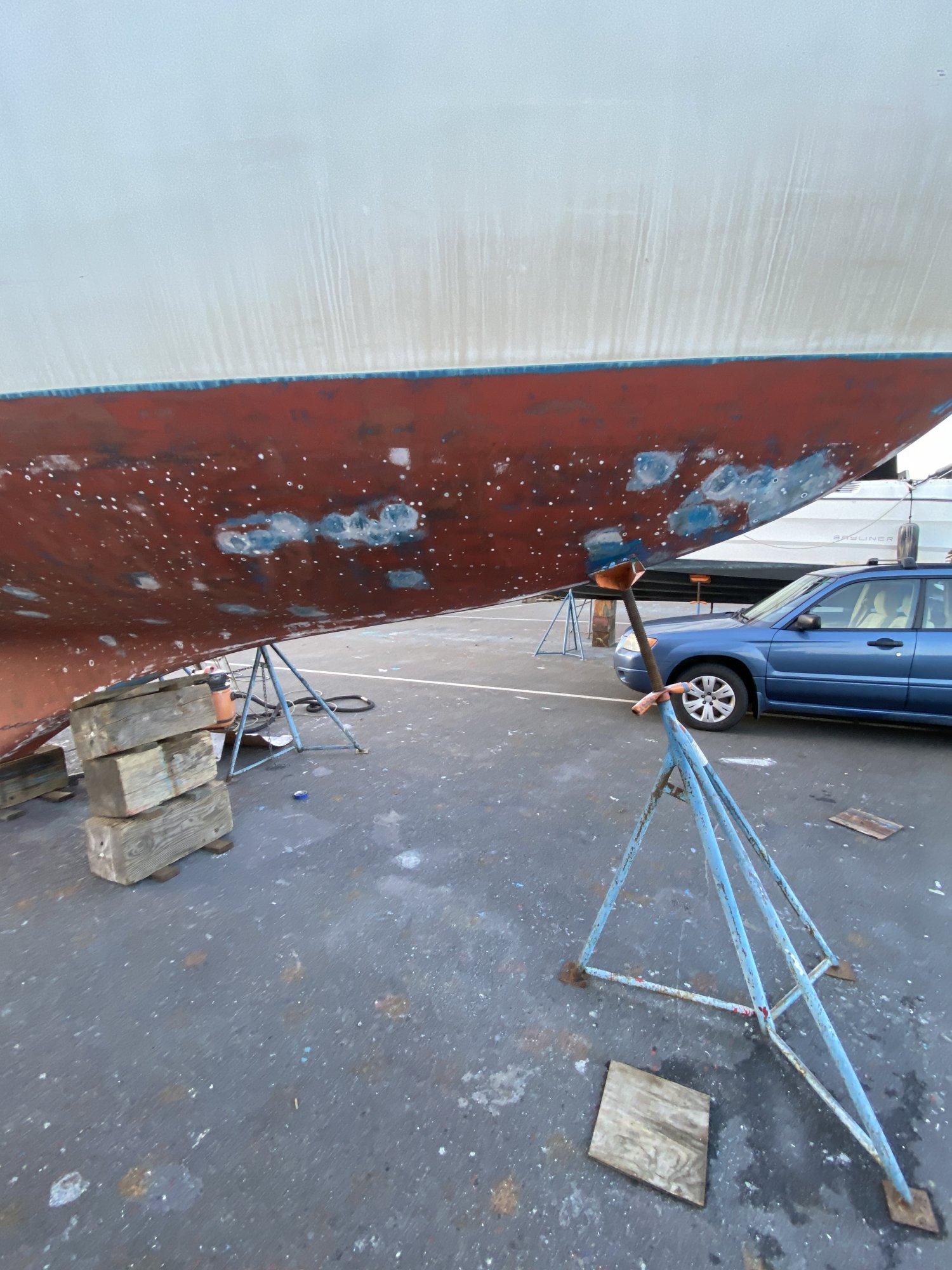

Jump 5 years forward to Feb 2023 and I again hauled the boat. Bottom had similar boat acne blisters.
After sanding the blue bottom paint and dishing out the more noticeable blisters

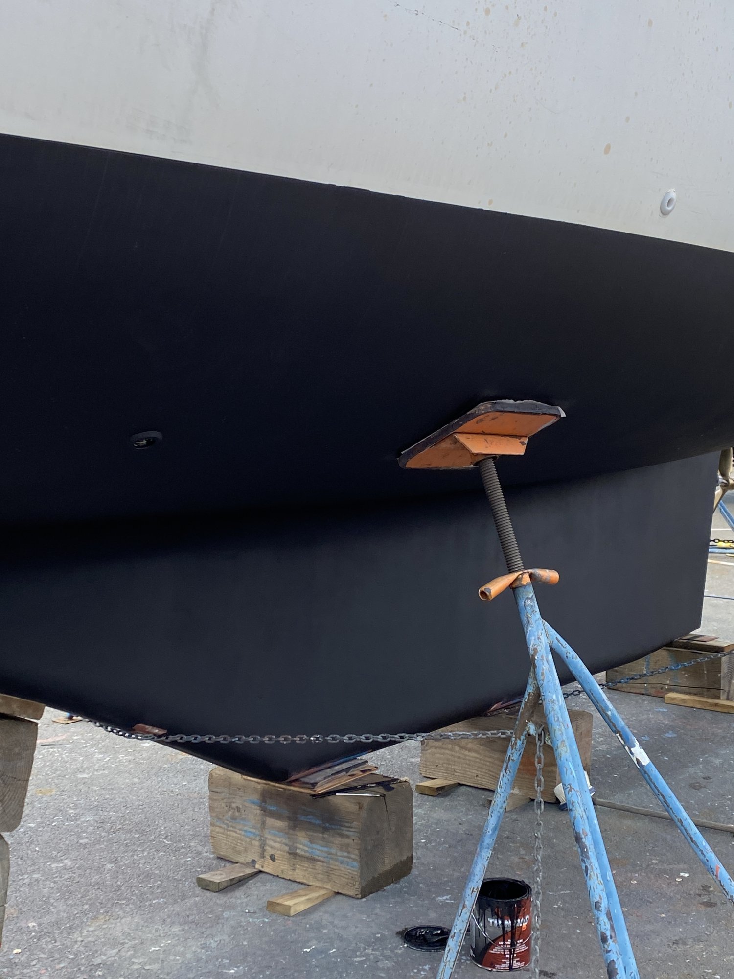

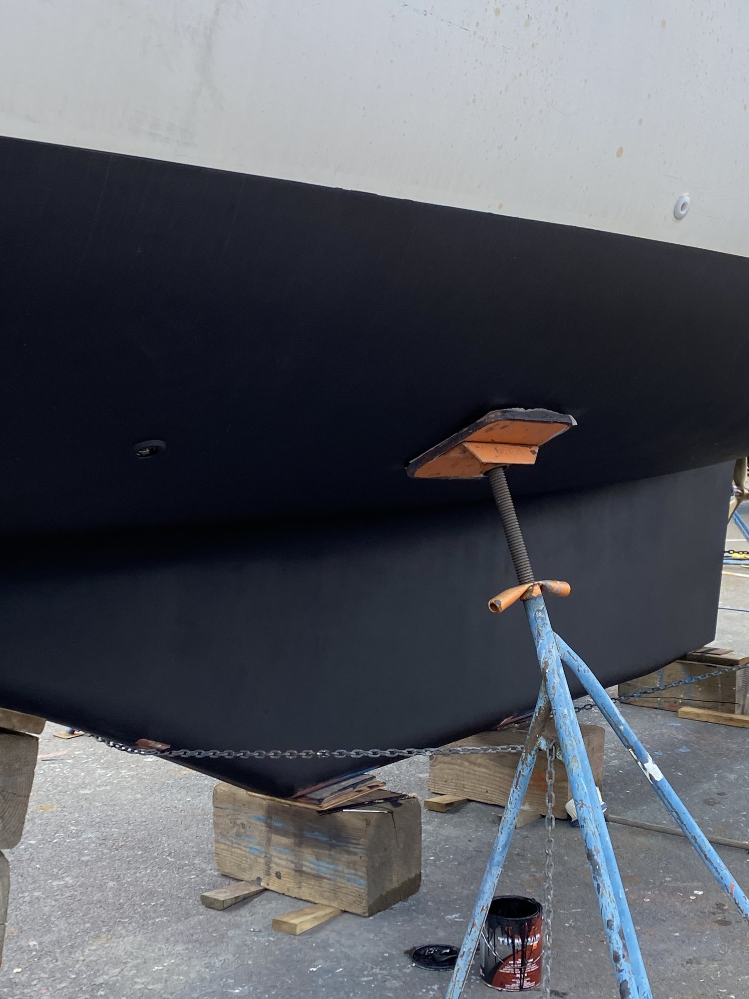

The offending acne was again filled with thickened epoxy and covered with 2 coats of barrier paint.
Then any remaining rough spots were sanded and 2 coats of bottom paint were applied.
A pleasing sight, smoothed bottom and boat splashed. Ready for another few years of cruising.
