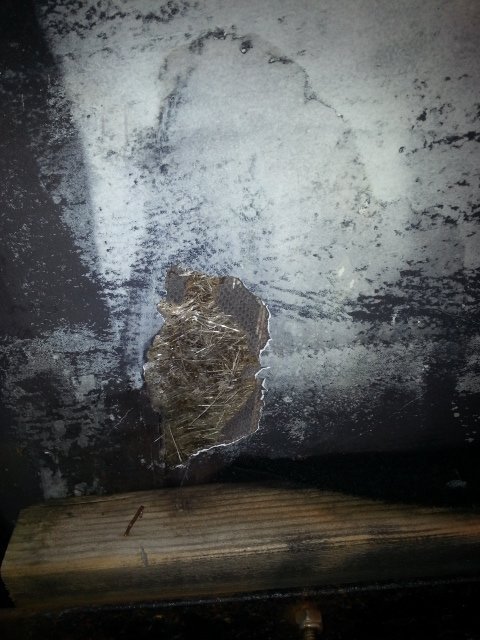

I posted this in another area first and was told what has happen weren't blisters. I don't know what it is and probably doesn't really matter. Maybe water was between layers of fiberglass and froze. Its a macgregor and Im not sure how thick the hull is....probably very thin.

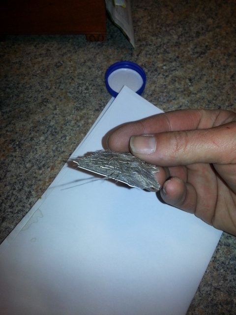

I think this is a blister. I have read quite bit about them and understand how it happens but I was a bit shocked at how deep into the fiberglass it went. Easily a quarter inch.

I pressure washed as much as the ablative paint off as I could. I fair bit of it was already gone. I was working on finding somebody to soda blast the boat to have a perfectly clean bottom. I noticed a fairly large crack. I stuck a screw driver and pried it open and then....ohhh my. Its right by the back bunk and probably eight inches by the time I take the boat off the trailer and grind it all back.
