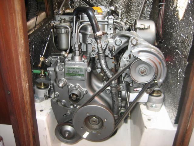

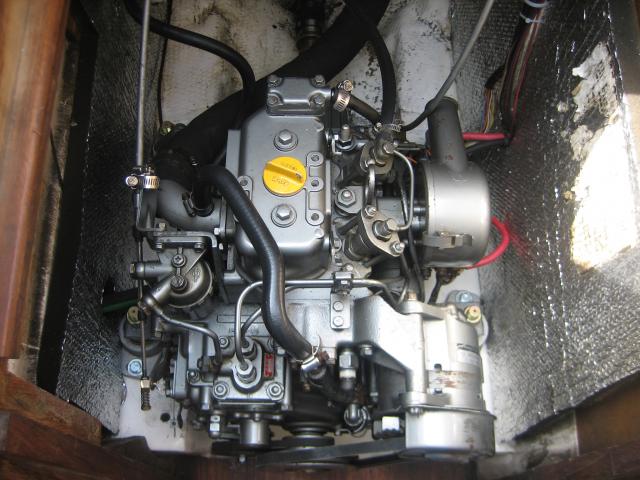

I have just finished repowerering my H27 with a Yanmar 2GM (replaced a Renault). I have a document that I am putting together that details the entire adventure (with pictures). But my question at this time is the Bleeding of the Fuel System prior to attempting to start the engine. I have attached a few pictures of the new engine in place.
Can someone provide a detailed list of how to do this?

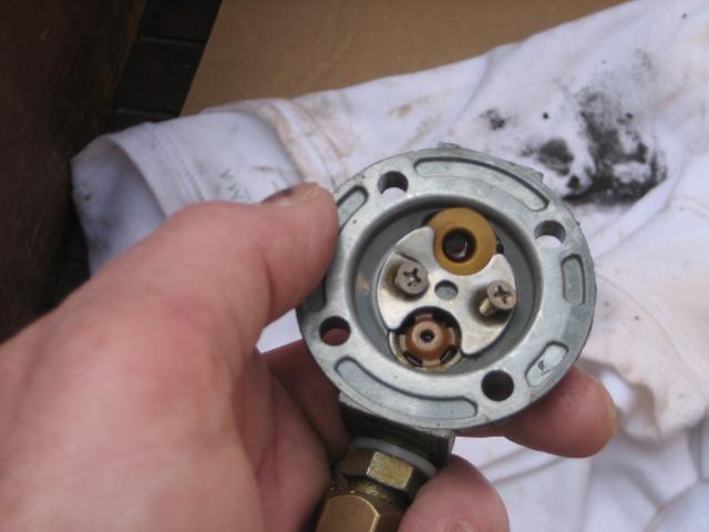

Today was the day to start the engine. I followed all of the instructions, even had a friend with to have two sets of eyes and two brains....first prepared the engine with fresh oil for the engine and transmission. Then connected the inlet water to run from a bucket sitting in the cockpit (with a hose handy to continue to fill). Began to bleed the fuel system beginning with opening the fuel tank cock. Opened the air bleeding screw on the fuel filter and began to operate the lever on the fuel feed pump. I pumped the lever up and down, and up and down.....waiting for the fuel to begin to squirt out of the bleeding screw.....but it just didn't happen....no fuel. So after a lengthly time of decision making, we undid the inlet fuel line to make sure that fuel was being delivered to the fuel feed pump... It was, so we reconnected the fuel line. Then after another attempt to bleed the system, we decided to turn the engine over to see if would help. We at first kept the bleeding screw open and hit the start button and cranked the engine....but that is all it did....just cranked. After a few tries we decided to check out the fuel feed pump and it's internal condition.
There is where we found the problem. The outlet valve, outlet valve packing and the metal retaining ring were damaged. The outlet valve was not even correctly seated. The diaphragm looked in good condition but I intend to replace all the internal parts as long as I have it apart. So now I have to wait until Monday morning to order the replacement parts from Torrensen Marine. It will take a few days to ship so it will be later next week before I can attempt this procedure again.

Man, What a letdown.. Sorry to hear that but you guys sound like ya have the situation in hand. I am not sure that you can get piece/parts for the pump, I think it is only sold as a unit.. Could be wrong.. I hope ya can, Morgan. Some folks on the forum have fitted automotive electric pumps and removed and blanked off the place where the mechanical pump fits..

Here you can see the inside of the Fuel Feed Pump and the outlet valve that isn't seated properly as well as the cracked retaining plate. I do not know if this was done at the factory and just worked all these years or if the previous owner changed it at one time or another and did not install it properly.
I will find out tomorrow whether I have to purchase an entire new pump or if I can purchase parts. I am tending to think I am going to have to buy the whole pump.
