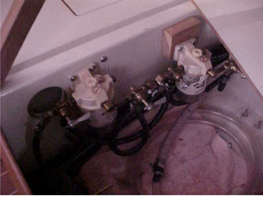

My efforts at routine maintenance have gone awry and I need some guidance.
I replaced 3 fuel filters (2 primary and one secondary) and am having trouble bleeding the system and getting her started again. I finally found the fuel lift pump on the starboard side of the Yanmar 4JHE, and have pumped vigorously trying to get fuel/air to come out of the secondary filter petcock.
Does anyone know how long one needs to pump this for? Should I loosen the injector bolts and pump as well? Does anyone know how much to prime the primary filters using the priming pump on top of the assembly? (The guidance in the Yanmar manual is not great).
The TLDR is below, and I've attached a photo of the primary filters (since I can't seem to find any info about these online).
Thanks in advance!
Long Version:
On Saturday, I changed two primaries and one secondary filter, but put them all back on without filling with diesel (and without bleeding). Then Started the engine. It ran for about 30 seconds using the existing fuel in the lines I guess, but then it died. Then we unscrewed all the filters and added fresh diesel. Then we opened the secondary filter petcock to bleed and opened one fuel injector to bleed. Tried starting it for about 20 minutes, and actually ran the starting battery down (this was Sunday). Then Monday, I tried two things. Each of the primary filters has a priming pump. So I pumped them for a bit. Then I found the manual fuel lift valve on the engine. I opened the secondary petcock and started pumping to see if i could get fuel out of the petcock. Nothing ever came out. I loosened a fuel pump bolt and saw some fuel come out. But nothing out of the petcock. I eventually tried cranking again and the engine started for about 5 seconds and died. So I think there is still air in there. I’m not sure how long I am supposed to pump the lift valve for or if I just need to unscrew all the injectors. (I also read about dangers of having the freshwater intake open while doing this, which I have, and so now I am worried about flooding the engine).
Thanks in advance!
Long Version:
