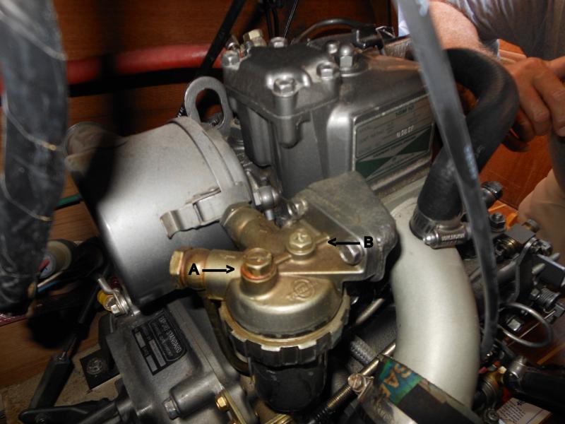

...on Yanmar 1GM10. See pic.
Which screw is used to bleed the air from the secondary filter, "A" on the left or "B" on the right? No indication in the manual, and most web references are vague.
Click the image to make it big enough to see.
Thanks.

There are 2 bleed screws there: the aft one is the inlet, the forward one is the outlet. The inlet one has a small nylon washer which wears after many bleeds and thus is known to leak. Should be replaced with a new one or a copper crush washer. The outlet one isn't normally bled.

I bleed at B on the right (although on a 2GM, the setup is the same).

I, too, would bleed "A" first and only bleed at "B" if I believed air had gotten into the secondary filter. I also paint the tops of all my bleeds screws, and the positive posts of my batteries, with a dab of red nail polish to make them easier to find in a hurry....

"B" is your bleed screw. Be careful not to overtighten it, because if you strip it, the filter upper head assembly is pretty pricey. If you want to use injector cleaner to fill your filter bowl, Sea Foam works well. In fact, they recommend filling your secondary filter bowl (the big filter closest to the fuel tank) with it and running it through the engine to decarbonize. Never had the courage to try it though.

It is invaluable and also very clear to understand with photographs and diagrams that will help you perform just about any maintenance procedure. The B screw is the bleed screw. If you look on the cover you can see the arrows indicating inflow and outflow (you can see them in your own picture). Yanmar is consistent ... all bleed screws are a 10 mm bolt with a Phillips head.
I have a 1GM which is essentially the same engine (smaller bore for the piston, though). You also have a bleed screw at the injector pump and I have had to bleed it also on one occasion. That occasion is when I learned how easily the screw can be stripped. If you look at it you will see that bleed screws have a hole through the bolt which makes it weak.
I had a short trip to my slip when I stripped it and there was no wind .... diesel fuel squirted all over the engine compartment during my short trip home. What a mess! Never again will I be caught without a spare ... in fact 2 spares!
