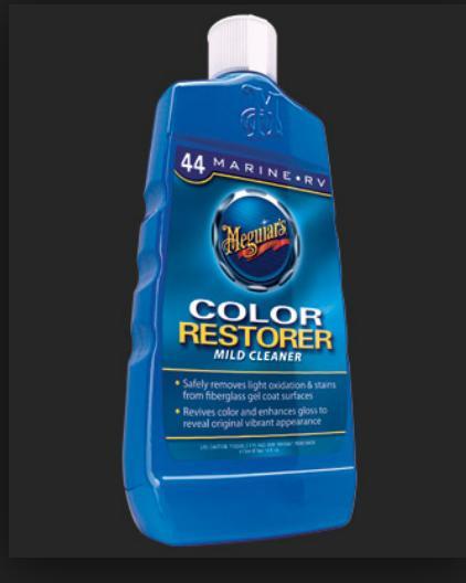

If all else fails, try Meguiar's Color Restorer. It's the lightest rubbing compound that Meguiar's makes and will only remove the oxidation. It did wonders for my deck gel coat after I sanded the bottom of the hull (along with the blue Micron CSC) and spent the next few days cleaning the deck gel coat. Getting ready to apply a barrier coat.

If all else fails, try Meguiar's Color Restorer. It's the lightest rubbing compound that Meguiar's makes and will only remove the oxidation. It did wonders for my deck gel coat .../QUOTE]
+1 on this product for brightening a dulled paint finish. Elbow grease not included in package - but needed.
If you ever find a good source for elbow grease, let me know. I'll pay any price.
