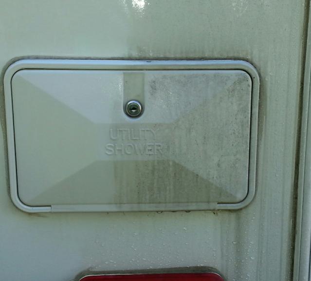

I've had good luck with Tilex Mold & Mildew remover. I had little black specks all over the cockpit that I couldn't get rid of no matter what I tried. Then I tried the Tilex and it worked! The best part is you just spray on, let it sit for about 10 minutes, then rinse. Attached is a pic from my Mom's trailer, which had a much worse version going on.
