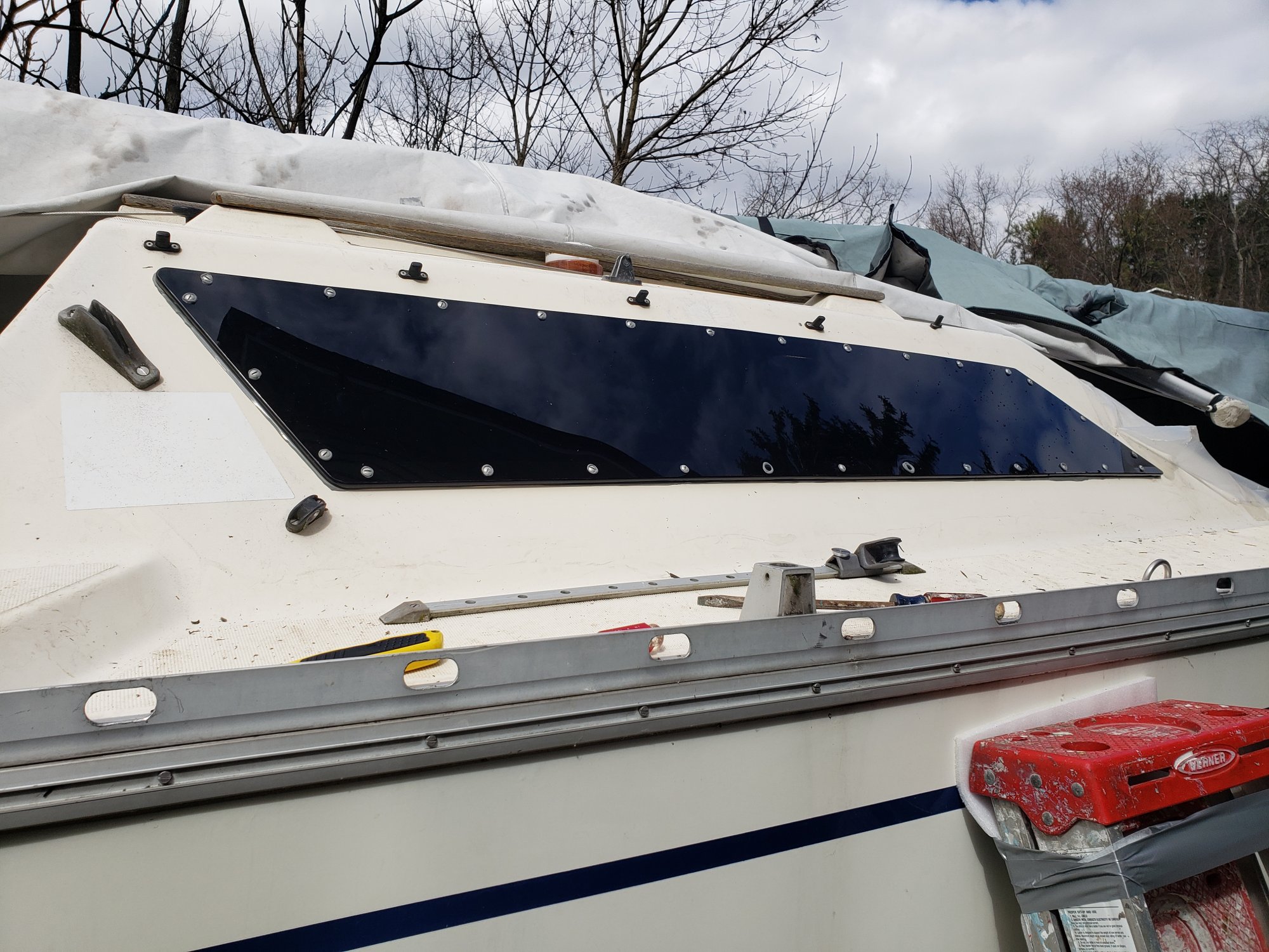

I love VHB and VHB + 795 is probably the best way to install windows, however my windows are mechanically fastened with aluminum frames. I debated changing to VHB + 795 but that would also require changing interior trim, changing my new curtains, etc. so I decided to stay with the current aluminum frames for now. I could prime the inside of the acrylic with black as is commonly done for Sika 295, but by using black (or gray) butyl I don't need to. I've acquired both the black XFasten and gray Bed- it and will try both for now.

My windows are in. I found the gray bed-it much easier to use than the black Xfasten. The Xfasten was too sticky making it difficult to apply. It would stick to my fingers more than to the boat. In addition the width was not consistent, but maybe I got a bad batch. The Bed-it was much easier to use. With my new dark smoke windows, I think the ease of use of the Bed-it wins or over the black Xfasten, even though you can still see the gray when the light is right.
