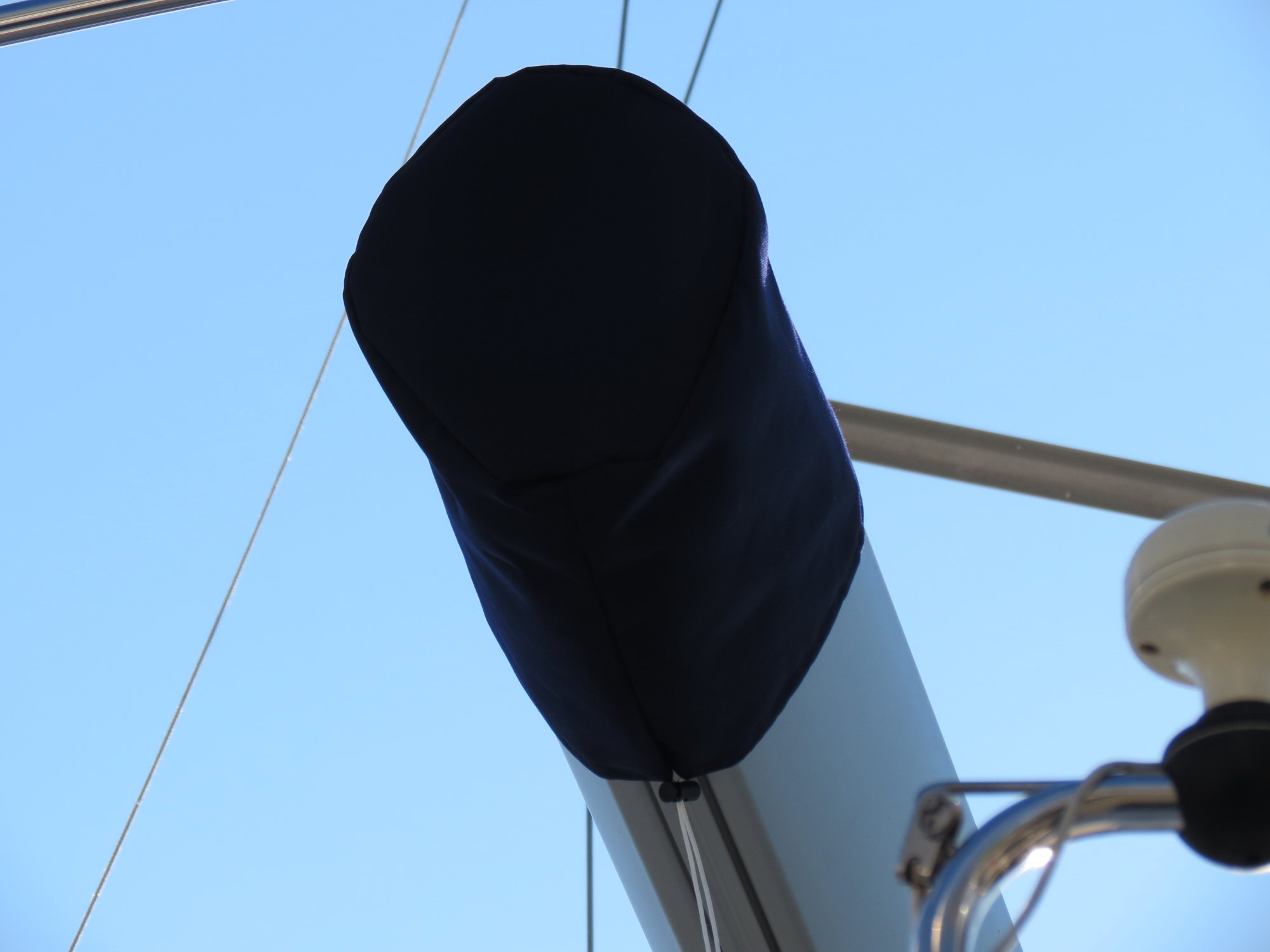

I feel your pain. Years ago I had birds next inside my Z-Spar boom. It took me 4-5 hours to rip all the inter-twined twigs and nesting material out of the boom. I tried everything- hosing out with water, wire snake with a hook to disassemble the nest, etc. It was a horrible situation.
But this only occurred in the Spring after my winter cover came off and never on my mooring. So from that point on, as soon as I took off the cover I immediately covered BOTH ends of the boom with pieces of shrink wrap material secured with duct tape. Problem solved.
Now with a different boom, I made a custom-fitted end cap out of Sunbrella that slides on and then pulls tight with a cord. No birds ever again.
BTW, I have never had an issue with squirrels. Just birds.

12,658
