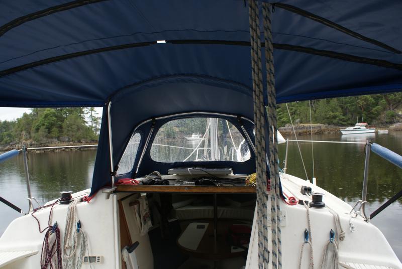

Sep 28, 2008
66
Hunter 26 Ghost lake
This works for me, no chaff or rub interference from dead down wind to close hauled. Big arc with lock-less zippers coming from sides and meeting in the center.
