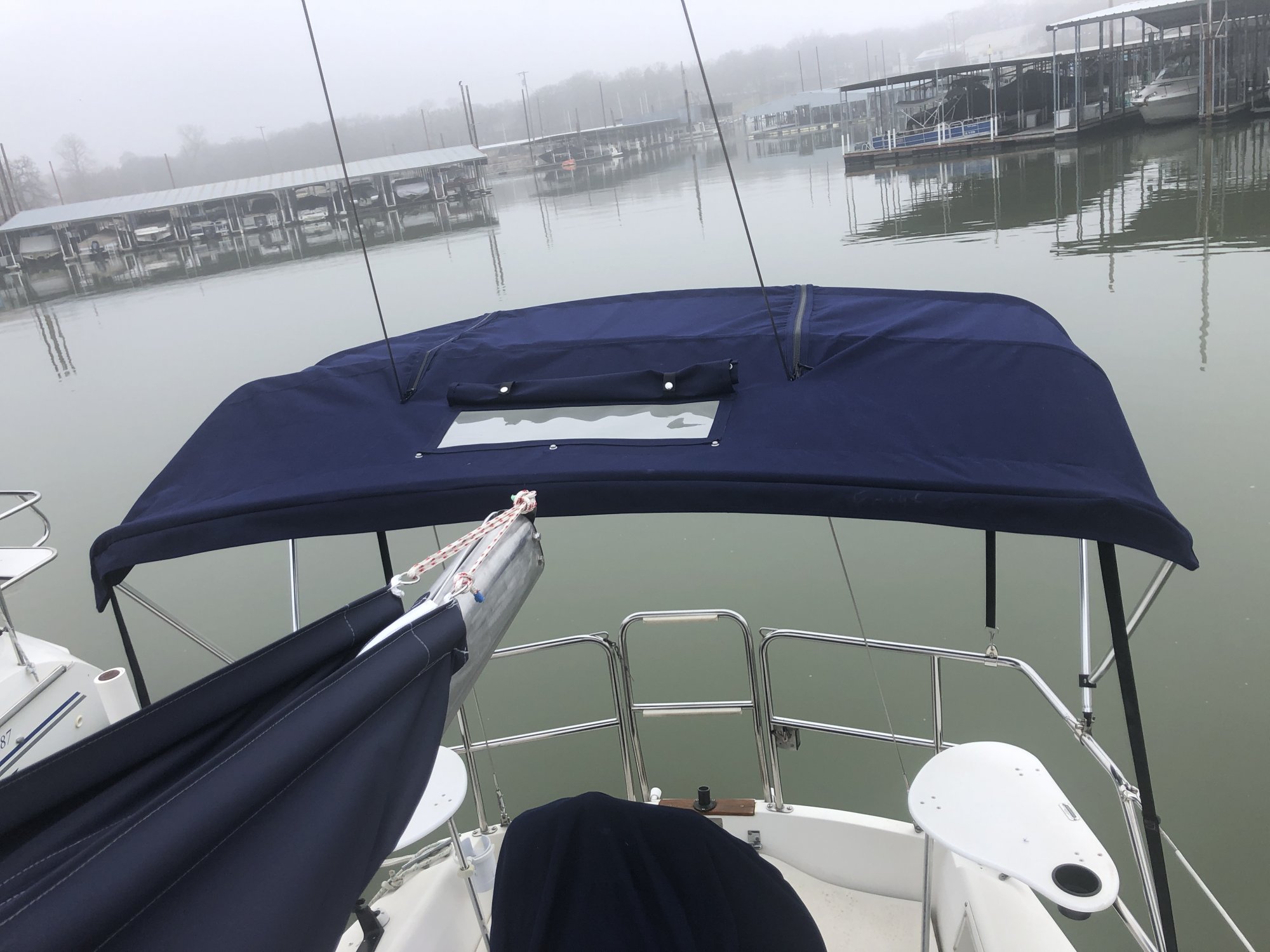

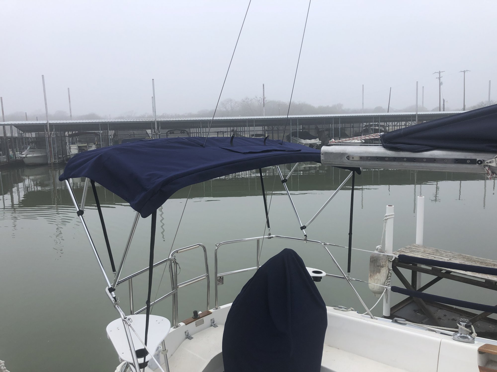

You have the right approach. Keep it simple. A roll up flap with snap or velcro closures is perfect. I would prefer the cover on the outside to protect the clear vinyl from sun, elements, bird poop, etc. This is a Catalina 30, but it would scale up to the Bene 423 bimini.
23,593
Greg, I can understand how having the cover on the underside of the Bimini would make using it easier. On the other hand, the cover on the top side acts to limit the UV damage to the (Essen glass/clear vinyl) window. It extends to life of the window.
It is the old boat compromise… Ease of use vs functional performance.
