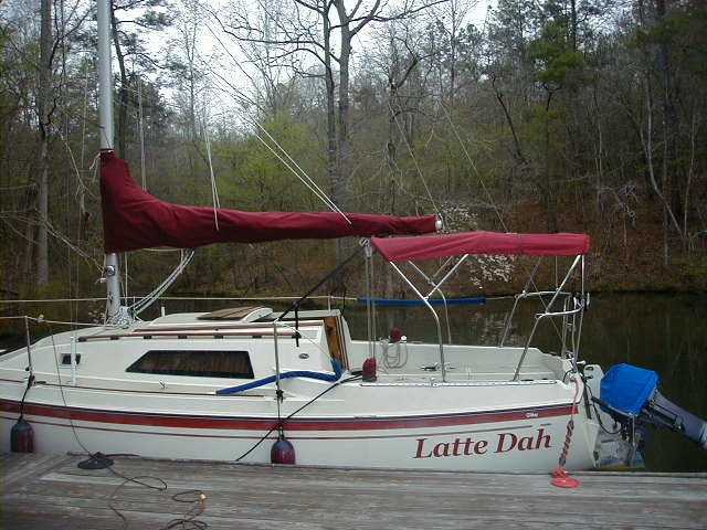

I custom made mine using the tips from Don Casey's book on Canvas and Sail Repair. I bought the SS tubing and Sunbrella material from West Marine, built a tubing bender from plywood, and started laying it out the way I wanted it. I just wanted mine in a different configuration from off the shelf models. Ben Allen ballen1@knology.net Montgomery, AL "Latte Dah" O'Day 26

I appreciate you sharing the pic and basic layout of what you did for your bimini top. A bimini top is high on my list for next year's add-ons to my boat. Thanks mark

Mike, Looks like you ran the backstay through the Bimini and re rigged the main sheet? Any comments on your approach would be appreciated. John

That's what I saw too and know that I'll have to do with my O'Day 23 as well, re-rig the mainsheet to the cockpit somehow if I wanted a bimini top. I'm interested in knowing how to set that up. Mark

The bimini was designed with a zipper so the back stay would go through it. The main sheet remained as original, with the bimini stopping about 2" behind it, although on the 22 or 23 O'Day, it would need to be changed if it attached to the rear of the boat. My next project is to make a cover that will snap onto the front of the bimini, then tie down to the cabin top handrails, so I can leave the hatch open in a light rain at anchor. Ben Allen Montgomery, AL "Latte Dah" O'Day 26
