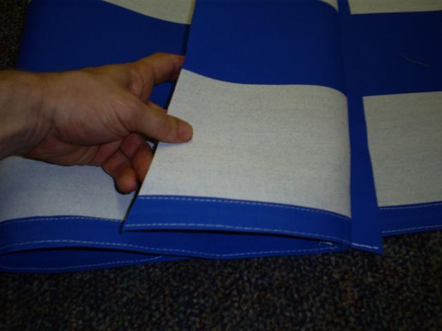

Hey guys. I was getting ready to sew together a bimini out of 9.25 oz sunbrella. I have my old one and was going to go by it for the pattern. I noticed there is a vestigial looking flap at the front and rear edge of the bimini. Other than this part the rest of the old bimini is a flat almost rectangle with a slight curve to the front and rear edge to match the bow of the poles at the angle they are mounted.

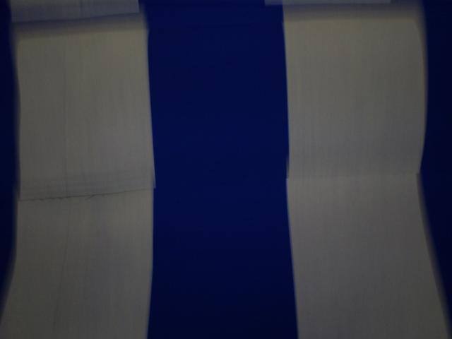

What are the flaps for? Will it look weird without it? I thought of doing a simple fold back over the pole like in the second pic. The first pic is the flap.

From what can be seen the flap looks like a way to hide and protect the raw edge of the fabric. A single fold back as you illiustrate would leave the raw edge showing which is not good since the fabric will friz on the edge unless you cut it with a heat knife. Would suggest first a 1/2" foldover to protect the raw edge and then you do the pole foldover. To make removing the bimini easier I would suggest the addition of a zipper flap overt the poles using #10 zipper.

Blight-in the first picture my fingers are in the pocket where the pole goes through. The flap actually sticks out from that kinda like a sideways mowhawk protruding off the front most and rear most edges of the bimini when it is installed.
I will sew a proper seam that is doubled twice for the pockets for the poles so nothing is fraying about. I have a soldering iron with a flat blade I use to coterize the edges also.

The eyebrows serve the function of routing water straight down off the edge. Without them, the tendency is for it to pool and run up under the edge and migrate across the underside until it drops, usually when it is just over your back.
112
Hunter 36_1980 Bass River, NJ
The piece you are refering to is called a hang down tail and per previous post by MJ, it is for deflecting water and acts as a drip edge. We ( my first mate and I ) just finished making a new dodger and bimini, so I am learning the parts 1st hand. Sailrite is very helpfull on any questions,also some decent videos if you get stuck on detail
