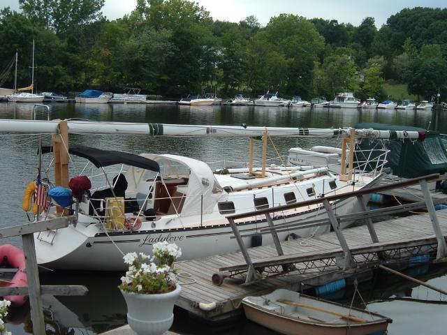

Where you are Jimmy you need a bimini. My H37C is exactly as you describe. I had the advantage of making my own from a Sailrite kit. So I was able to work with adjusting the frame for the boom and winch clearances. Then I mounted it on a 2x4 frame in the basement for measuring, cutting, and sewing.
The mid-bow and aft-bow are about 6'4" as I am 6'1". The forward most bow is just low enough for the boom to clear when sailing. And I have to duck a little to get under it. I only have the one slot for a center backstay. But that gives me 12" more cover behind me, very important.
I tapped and machine screwed the mounts to the toerail to get maximum width. Simple straps to the pushpit rail and two to rings on the toerail keep it up. I will look for a picture to add here to give you an idea of the shape.
Pic: End of Erie Canal on the way to Florida
