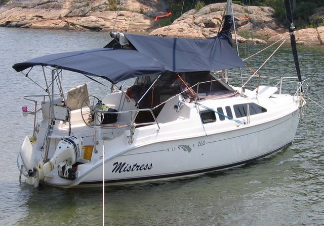

I think you'll find there is no problem with it up other than it might block your view of the mainsail. My wife insists on having it up when sailing, but when alone I keep it down. Here's some more stuff about bimini's which can be obtained at the sailboatowners.com chandlery.
Go to: http://h260.com/bimini/bimini.html

Does anyone have photos of a 23.5 with a bimini installed? I would like to see what it looks like.

Nicky, bimini is must equipment
at least on my boat. Can't see any sailing issues except visibility as previously stated. I have a custom two piece bimini. If its not terribly hot out I use only the aft one. ( see album on my profile page ). The aft one allows use of the stern seats and standing room at the helm. The forward one is near standard and blocks view of mainsail and makes going forward a pain. However; with both biminis up and 10-15 knots of breeze life is good in the shade.:dance:
