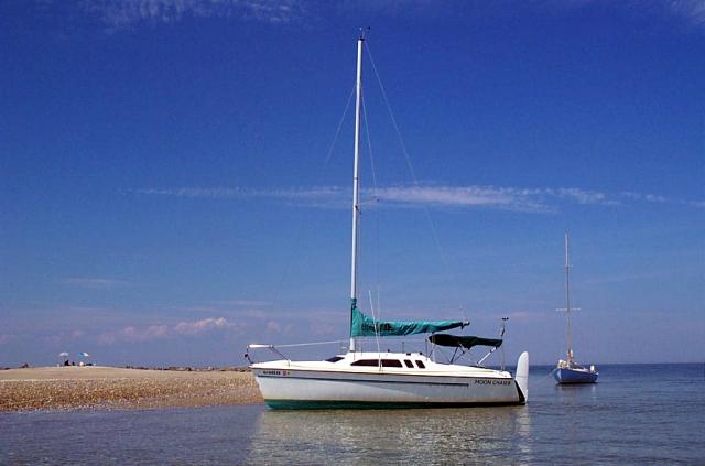

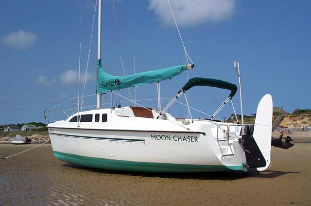

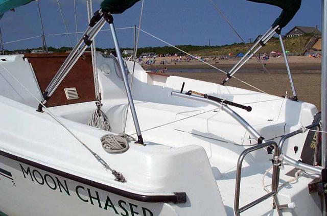

Hunter 23.5 Bimini
Here is my 23.5 with a bimini ordered from this site. Took me a few hours to install. Measure twice,drill once ! We sail with the bimini "up" and no problem with boom clearance.
