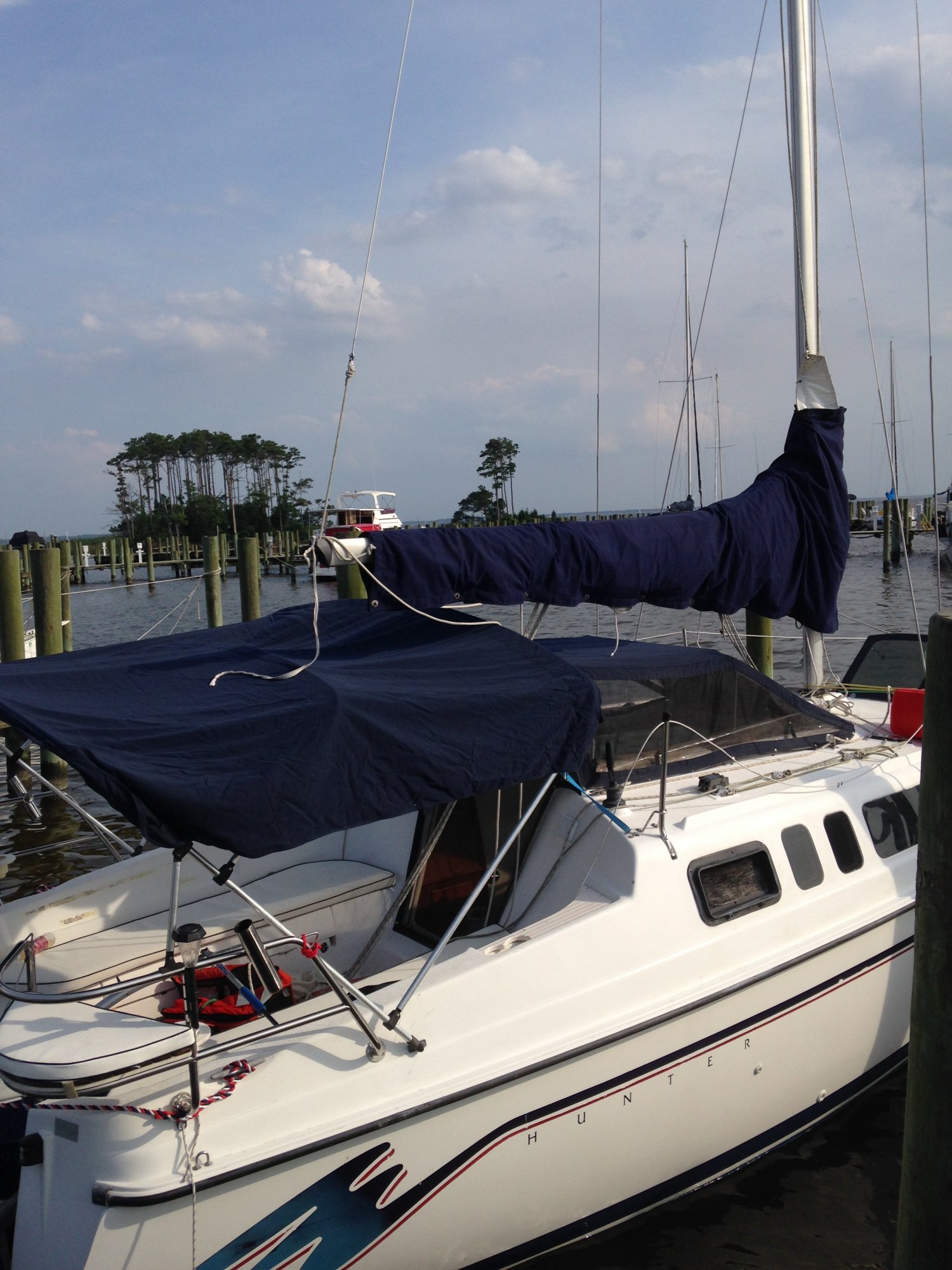

it attaches forward of mid-boom and the angle is such that it gets under the bimi.
