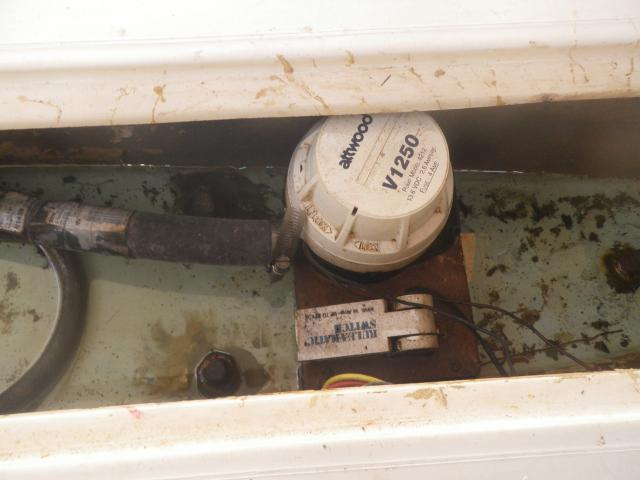

I took Don Casey's advice and installed 2 pumps. One is up on a little pedestal with a float switch the other is a small manual pump that pumps to a reduced 1/2" hose. This keeps the back flow to a minimum.
Please forgive the dirtiness of my bilge, that's a project for another year.
