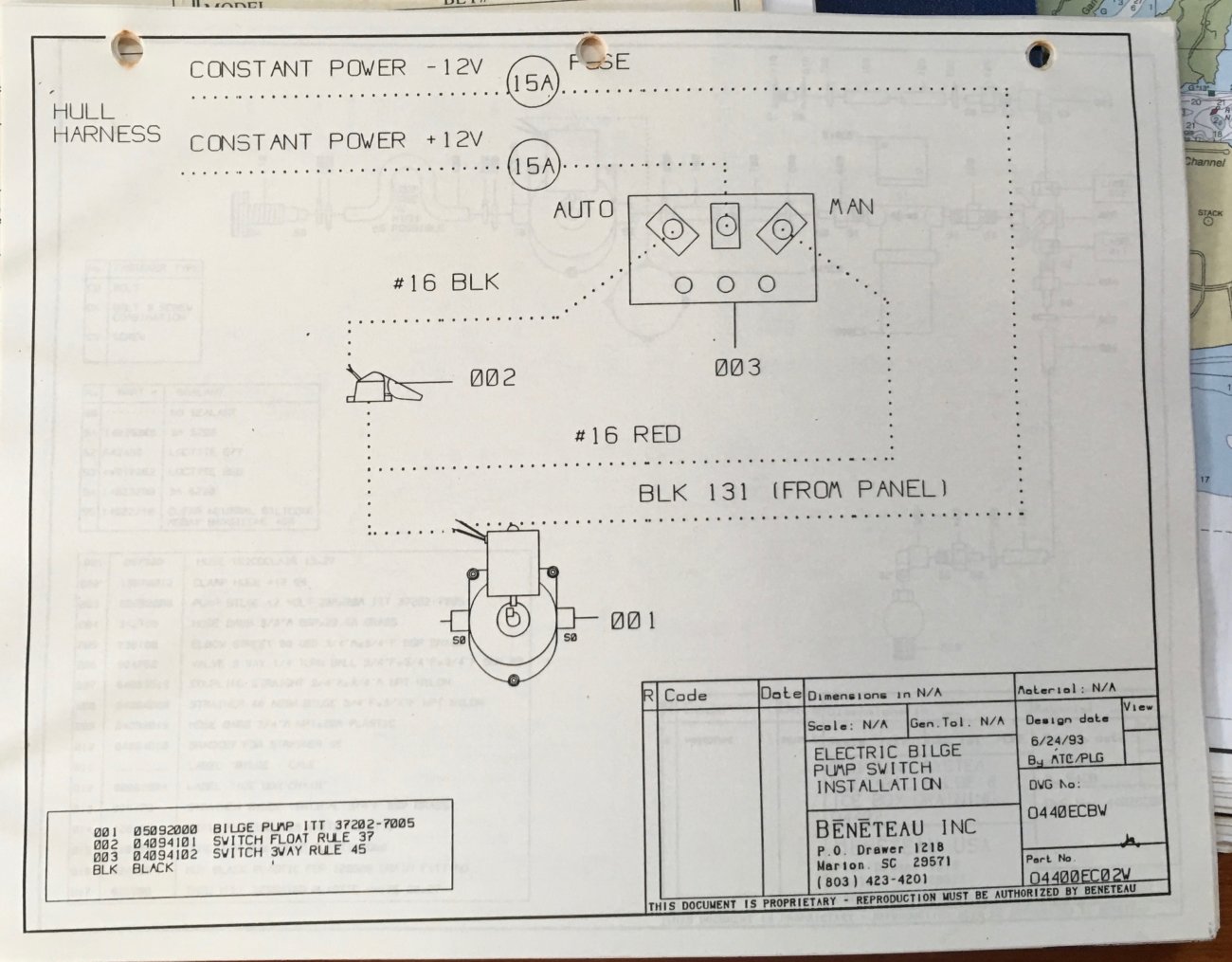

Over the season my bilge pump on the '95 OC440 (a diaphragm pump with a separate float switch, panel switch and separate Manual/Auto switch - see digram) stopped working. I could not figure out why. Was it the pump, the wiring, the float, the battery? Well we checked the pos/neg/grounds from the battery to the panel, from the panel to the relay and from the auto/manual switch (tested volts when switch was in both positions) and all read good voltage. We than got the bilge to work from the panel switch and when in manual mode, auto mode stayed on without float engaged.
Has anyone else experienced this? Very frustrating. Last stop is to try a new new float switch, it doesn't make sense... Thanks for reading and your input. Hope you have a great sailing season.

That drawing is horrid
1) I don’t know what you checked on the relay but there is no relay on that drawing, and usually isn’t on most installs
2) the switch can fail on. I would make sure the switch is not hung up on something before replacing it.
Do you really have 24V on your boat??
23,540
I don’t think it is 24 volts, just the French way of labeling the diagram. +12 and - 12.

A couple of clarifying questions - first, I presume that "constant -12V" on the diagram is really ground? Also, you said -
But I don't really understand what you mean by that. Did the pump run in manual mode? What do you mean by auto mode staying on?

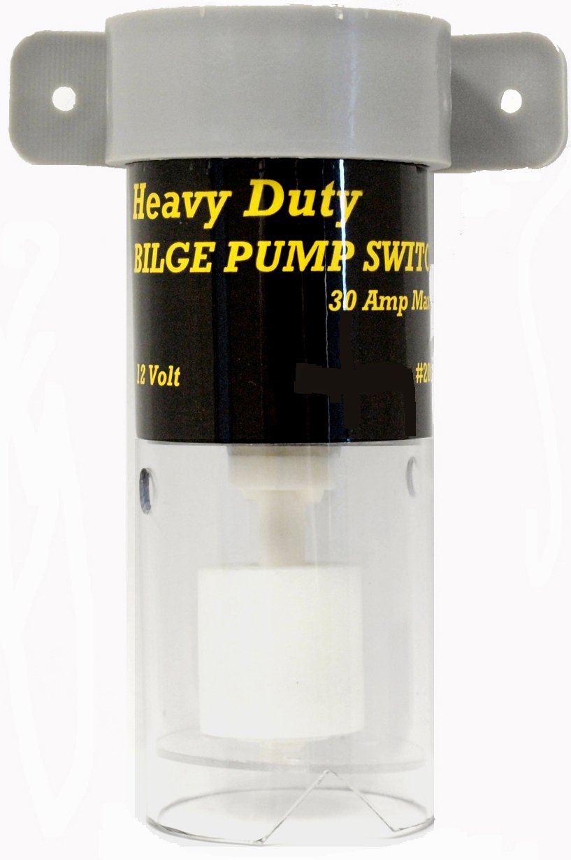

More than likely the float switch, I had the red manual led light even thou it was in auto ..water inside switch. In my boat the bilge goes about 3 inches deeper into the keel where the pump pickup sits. My float switch sits higher and would need almost the bilge filled before activating .I bought this sealed switch which I will install in the lower bilge in parallel with existing giving two float switchesbilge switch.jpg and activating much sooner

I tried that same switch on my C30. I'd didn't work well because the throw was too short so it kept going on and off.

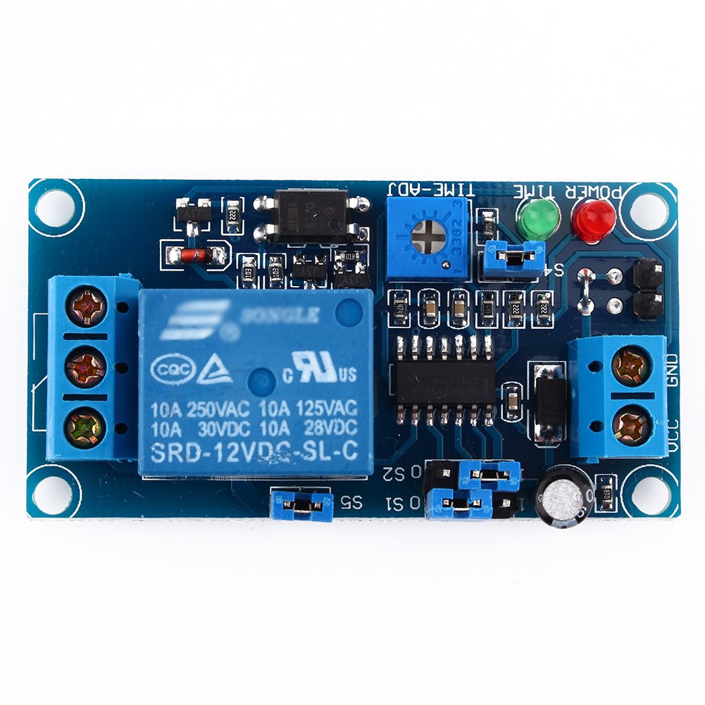

Thanks , I usually don't get any water in bilge ,but the couple of times I did it was really full (high) hose on A/c was leaking for condenser and had A/c condensate suck line plug a couple of times over flowing pan into bilge.
