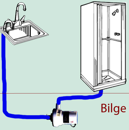

I found it. It's definitely my head shower drain. When I closed the forward thru hulls my bilge stayed dry. Then one time it rained and I forgot to close the head window, the sink and shower filled up with water. Guess what? Water in the bilge.
So, somewhere in my hoses or in the pump itself I have a leak. It's pretty low priority though since I can just close it all up and not worry about it. What I can't see is how the hose attaches under the shower inside the bilge. The hose that goes from my bait pump up into the bottom of the shower appears to go inside another much larger hose and from there on I can't tell. Hard to describe, I'll take a photo tomorrow. This is my shower drain setup:
Yes, there's no "bucket". It goes straight to a sealed bait/washdown pump then pumps out to the sink.

Here's what's in my bilge. I had to rebuild it once, and the original pump wasn't available, so I 3-D printed the piece to make a regular cheap pump into the same part:
The shower drain goes to the inlet nipple, and output goes into a spigot on the head sink. I don't have a pic of the head sink, and don't see any online, but I'll take a photo next time so you can see the spigot.
