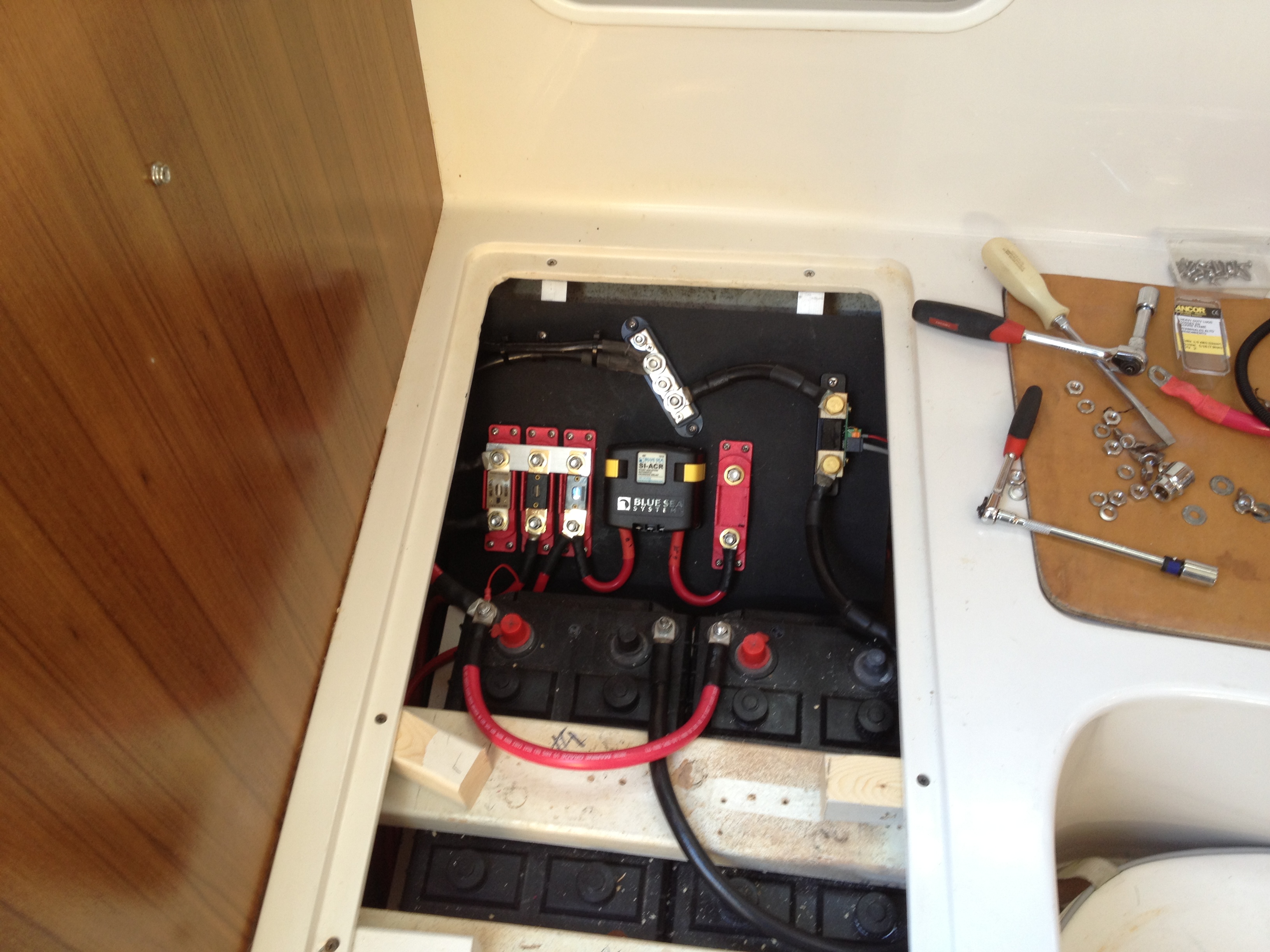

How did you positions the batteries? Can you show us a picture?

This is how I positioned the batteries the 12 Volt 27 and 3 of the 6 Volts in the main battery compartment then the other 6 volt in the adjacent compartment. My understanding is that the batteries should be orientated port to starboard, that will minimize leakage when healing. The 6 volt in the adjacent compartment is not oriented correctly so it could be a leakage issue. In my other boat I never had an issue about leakage and the batteries were not oriented properly. Will find out. Any history on this subject.

Sorry to side track your discussion a little bit, but why didn't you put the group 27 in the other storage area? It would be cheaper to replace than the 6 volt and those are going to get most of the work anyways.
I had to sacrifice orientation on two to get all the batteries into the same area. I didn't want to give up the area you but the battery under the settee because that is where my diaphragm bilge pump is going.
Looking at your batteries the two things I didn't see were fuses and a tie down system. Do you have those? Looking at your setup you need two fuses on each bank. A fuse for the 2/0 AWG wire to the battery selector switch and a fuse for the 4 AWG wire to the battery charger.

Tie downs are coming later, to put the 27 in the other compartment I would need to extend wiring. The AC charging wires are fused it is hard to see it. I have seen several different articles on fusing the main battery cable, when I bought the boat it wasn't fused. Still looking at the pros and cons. Thanks for any advice.
These must be the 40 amp slow-blow glass fuses in the inline holders that Catalina installed factory. They don't make the correct replacement fuses any more. Replace them with either ANL or MRBF fuses.
I did this by creating a positive fuse/distribution buss at the batteries. Here is an early version before I added solar and an inverter and changed to golf cart batteries.
Note the black ANL fuse. These are cheap POS that are dangerous. I bought them to try because they were half the cost of the Blue Sea Systems ANL. You get what you pay for. My first problem with these was when we were in York Harbor. I checked the batteries and I was at 65% SOC. No problem, I'll just run the diesel. An hour later I was at 58% SOC. What happened? The cheap ANL fuse wasn't letting any current through even though it didn't show as blown. My next problem is they were blowing on the ignition side for no reason. Maine Sail has since done a write up on these cheap fuses. Stick with the Blue Sea Systems ANL fuses. The cheap fuse holders from Genuine Dealz are OK but I wouldn't buy again. I would just stick with Blue Sea Systems. Sometimes the quality can't be match.
There are none, zero, zilch cons to fusing the main battery cables on an auxiliary sail boat. I am sure if you take another look any discussions of not fusing are based on large, power boats.
